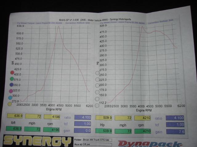

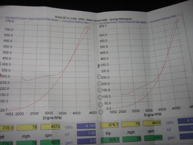

I have the 02 zo6 cam with the stock 5.3 and 6.0 heads. Here is the dyno. The dyno says flywheel hp but it is to the wheel. I don't know why it says that. This was at 25psi. Hope that helps Jim!

Opps, one was 25psi, I dont know the modes on the second but I think it was 15psi.

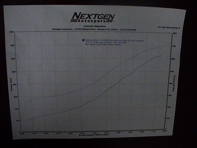

Here is a dyno jet and 17 psi on MAF tune 3.73 gears.
