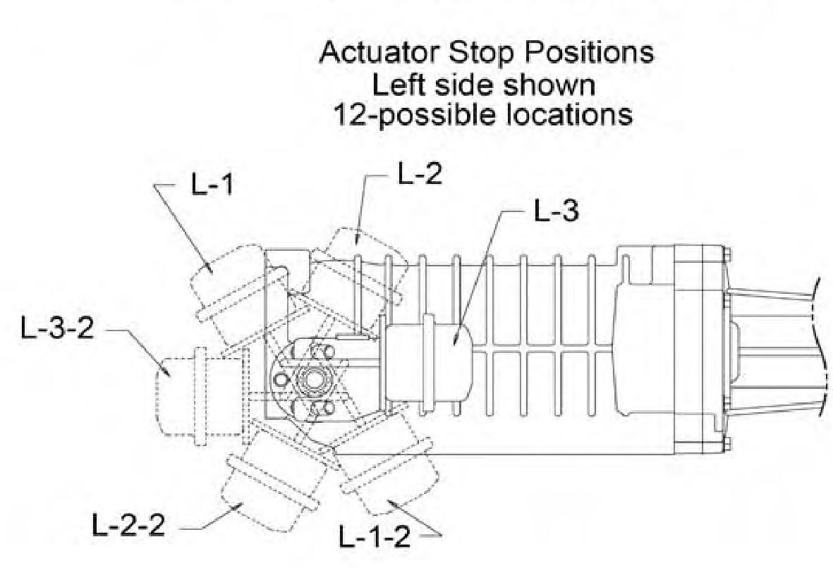

You ran the BLK not the BLK/WHT wire to the IAT sensor, correct?
The lever arm on the bypass actuator shaft has a number stamped on it that should match the actuator mounting position. There are R and L versions of each.
Attached Thumbnails Just got the Maggie done-maggie-bypass-actuator-positions.jpg
Yes the black wire. I will look at that and see what it has on it.
It is at L-3 and that is what the arm has on it.
