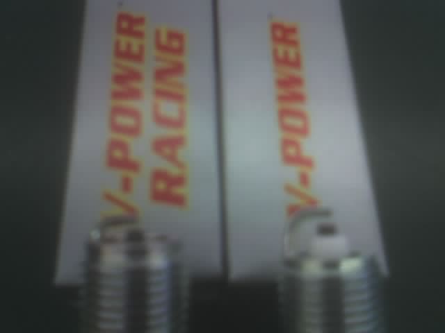

As I understand it, in our FI applications, it is not so much that the 4554 is a colder plug than a TR6...it is the projection of the tip being less than that of a TR6 that is desirable...I will add pics of them side by side after lunch...

not very clear picture, but the difference is very clear...
I agree. A TR6 can work well up to 14psi on a Lightning and even higher boost. For safety sake I wouldn't want to go past 14psi though.
Regarding insulator projection...If you want to go inbetween the TR6 and br7ef a stock Lightning plug or TR7ix would do nicely.
