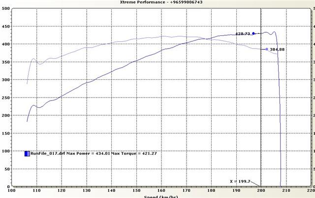

recently i installed pro charger p1-sc1 on my 2007 envoy denali 5.3L
my engine is totally stock internally , also the trans ,,,
so far with 52 injectors , and 10 psi + methanol we made 434 HP and 421 TQ
also logtube headers from American racing , reason we use methanol is to drop IAT from 50c to below 30,s , anyways , i would like to replace the inatke manifold with LS2 intake manifold ,
my Q is ,,, can i do it with out alternator relocation ?
my friend has 98 C5 he made 90 HP with LS2 intake manifold he had novi 2000
i,m looking to increase HP all the way to 500
ANY idea,s
thanks in advance

I don't believe your friend. An intake manifold is not going to give you 90 HP. I think you should look elsewhere to make more power.
If your IAT was 50° C before, you must have an intercooler? If not, where is your IAT sensor?

all i know is i was there withhim when we change it from ls1 to ls2 intake and he had the MAF canceled we tuned his car by 2 bar map sensor only , its a corvette 98 , with 98 octane , ,
