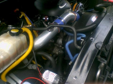

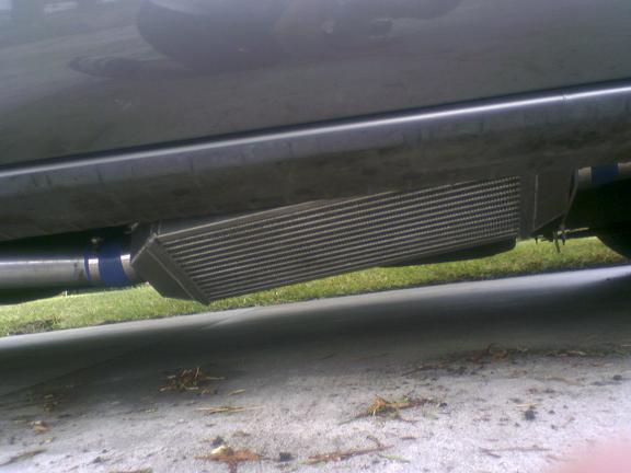

yea i wouldnt mind seein some pics of that side mount IC either

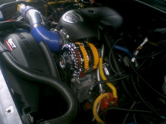

sry the pics are crappy it was on my cell. i also took a pick of the alternator i made at my shop.
