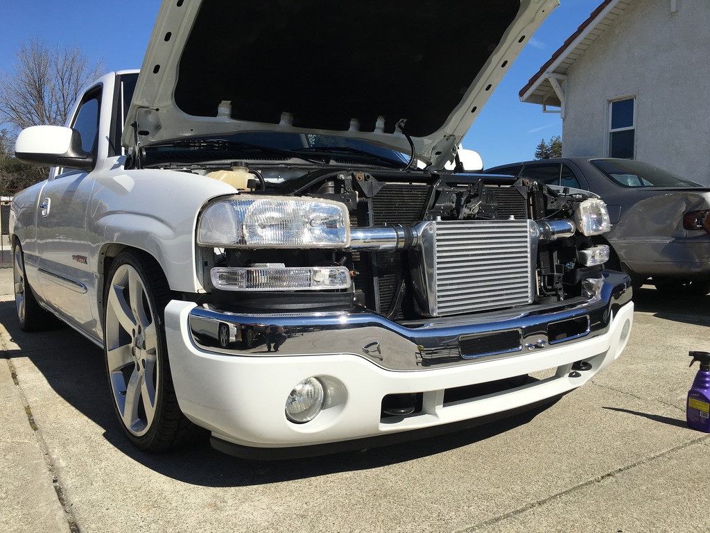

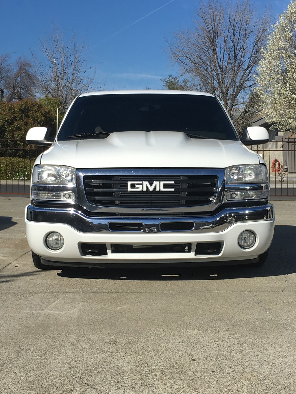

The cooler is 25x12x3, but the core is really 18x12x3, and its mounted directy behind the grill. Nothing but the slats in grill blocking air. Seems small now that I think about it.

The temp rises seem OK. 100* really isnt anything to worry too much about.
Next time keep it buried longer and see how drastically they keep climbing. On pump gas justr make sure your IAT timing tables are set OK to pull timing at a certain IAT temp to keep things safe.

Prochargers create heat when spun...anything less then a 4" core is a joke on a v8

Originally Posted by MikeD.
Off topic but that sure is one clean GMC !
