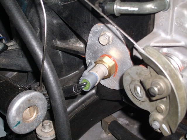

I used the MSD sensor.
thanks bro.. back on topic
