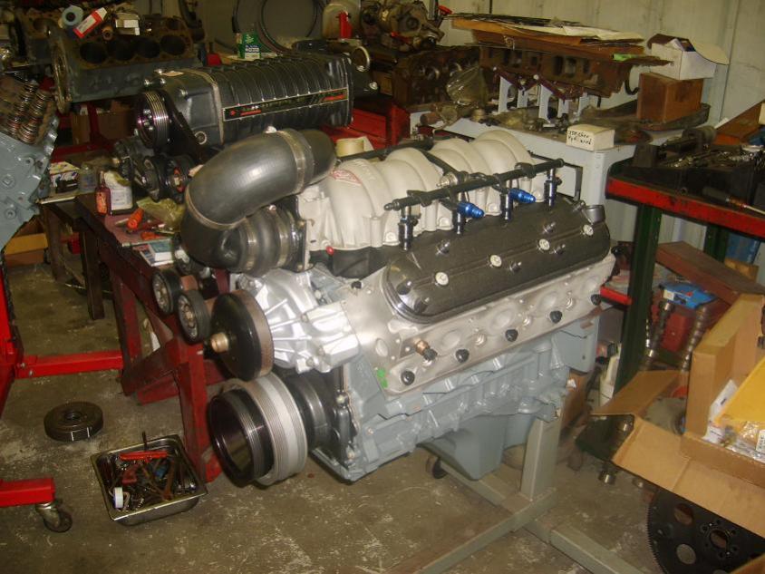

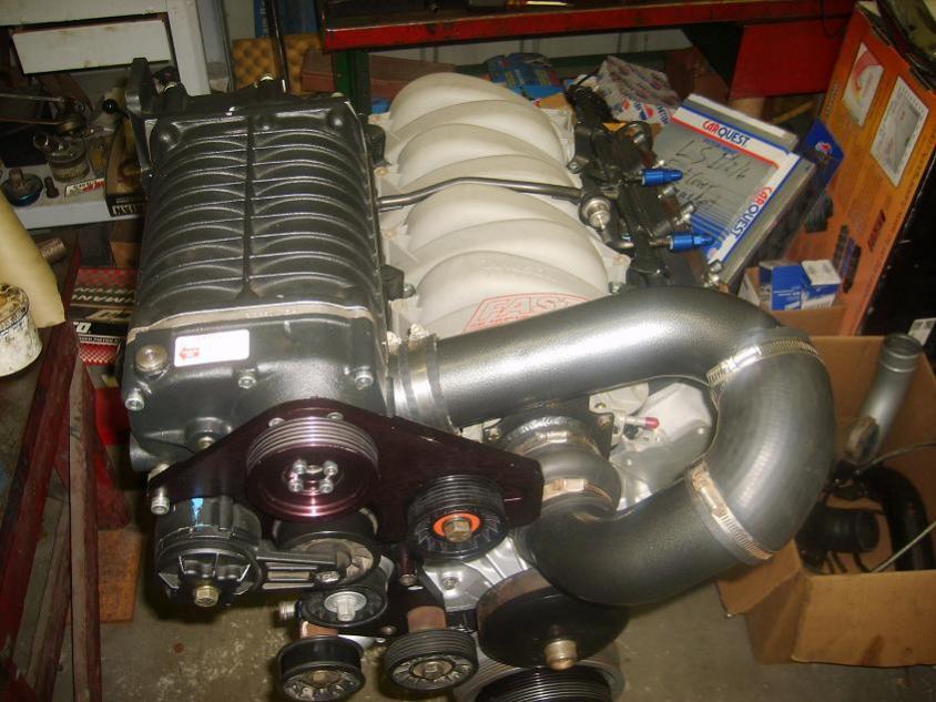

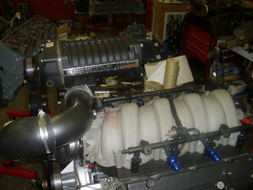

Hi everyone! I have built a forged bottom 6.0 with Z06 valvetrain, P&P heads, Fast 90 manifold. Then I picked up a 2 belt whipple for a good price. I moved the blower out to the side and up 1" diagonally by modifying the mounting brackets to get the discharge to clear the top of the fast 90 TB flange. Made some custom tubes and flange and got it on there. IAC bung on the back side of the discharge tube too.
Back to my questions. I measured the outside diameter of my pulleys and this is what I got. 3.5" on the top and 6.25" on the crank. Does these sizes sound familiar? Anyone know how much boost I might have with this 6.0, with flat top pistons? What would I need to do to get 10 pounds of boost? I know I have my idler pulleys mixed up in the pic, it's just mocked up. Thanks

Clever way to re-aim the discharge! You'll probably get about 4 psi with that pulley combo. That will be fine with the right injectors and a tune for now. Don't worry about increasing boost until you get your intercooler installed. You should be able to get 10 psi with a 2-3/4" or so top pulley. PM me when you are ready, I have a pulley or two for sale that might get you 8 psi.
