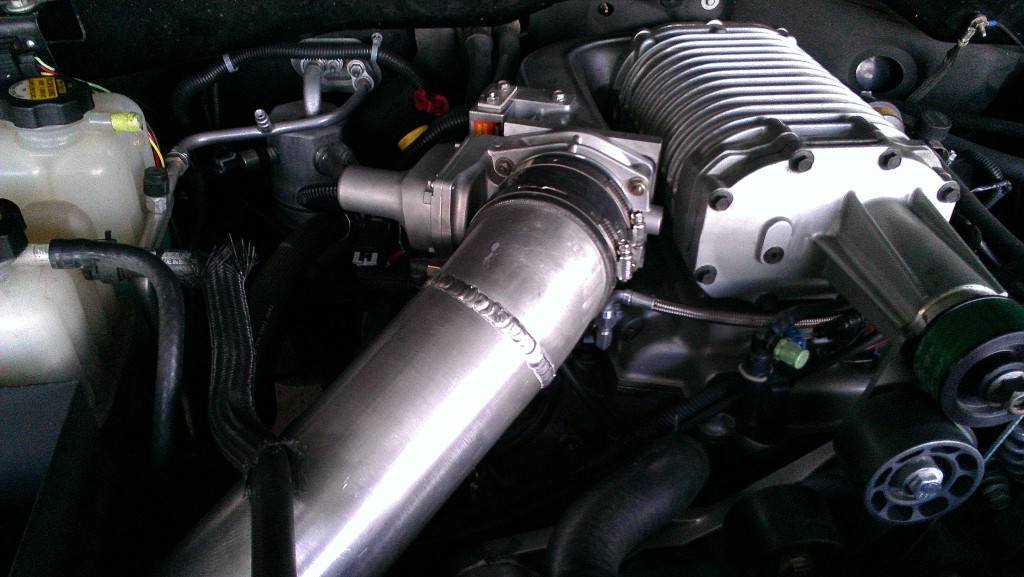

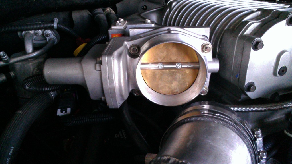

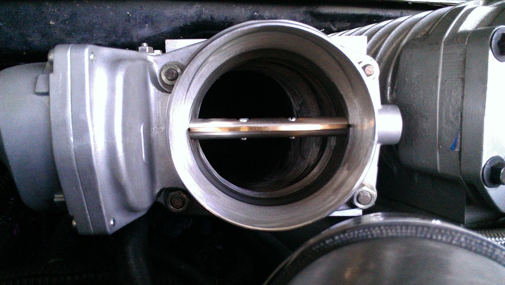

Well I have been trying to find out what throttle body I actually have. When I purchased it, it was listed as an LS3 LS7 throttle body. From what I am gathering, they are not the same. The throttle body I have has a gold blade. My throttle body is mounted so that the motor and TPS is off to the passenger side of the truck. If you are standing at the passenger fender, the TB blade turns in a counter clockwise direction. I would like to try a TB that when mounted the same way, turns in a clockwise direction. I figure if the air is forcing mine opened, if it were in the other direction, it would force it closed.
Old Jun 22, 2012 | 03:58 AM
  #27
03sierraslt's Avatar
Posts: 19,007
Likes: 221
From: Western PA
LS3 opens the same direction as the truck throttlebody, the LS2 opens the opposite direction. This is part of the reason some require the wire to be cut on the X-Link. Take a picture of your TB and post it up.
Old Jun 22, 2012 | 07:30 PM
  #28
Gadgetized's Avatar
Joined: Jan 2010
Posts: 3,095
From: Rochester, NY
Well here is what I have on there now. I made a CAI, and it sort of angles up a little. That isn't the problem though as I still get the problem with the CAI removed.

Post up a copy of your tune
