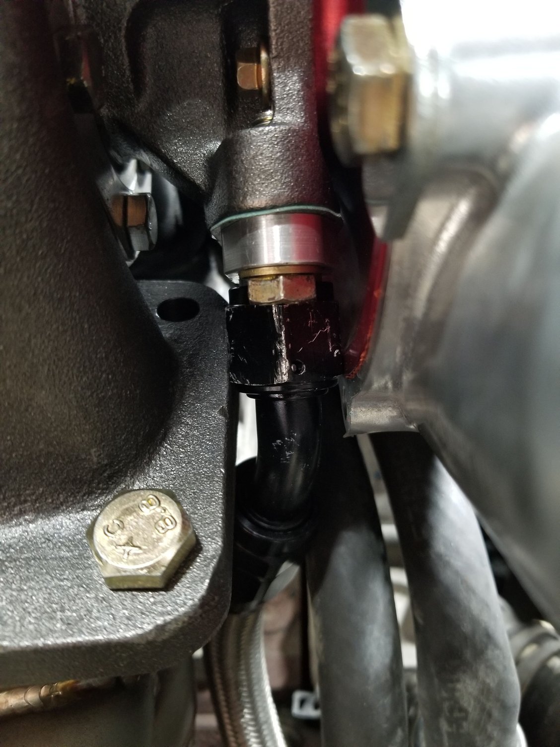

Also the oil outlet on the huron speed turbo is a complete pain in the ***. The drain hose needs bolted to the outlet manifold and clocked correctly AND you have to ditch one of the compressor clamping bolts in order for it to fit.

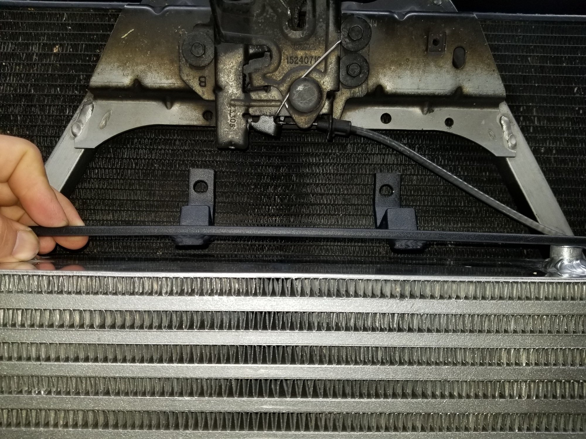

Intercooler mounting bracket is too short???

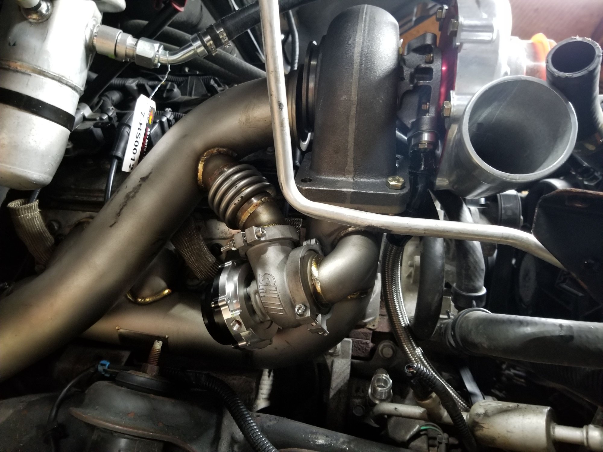

FINALLY starting to get this installed.
my 90 coming off turbo is smashing (deformed) up against the thermostat housing. Anyone have a remedy?

depending which turbo you are running, this outlet may be higher or lower than another. If you are too low and touching the t stat housing on the coupler off the turbo, you can simply trim the coupler a bit on the turbo side to slide it up higher on the turbo and it will give you more room here. Anything you need always feel free to reach out direct, always happy to assist! Jon@huronspeed.com
