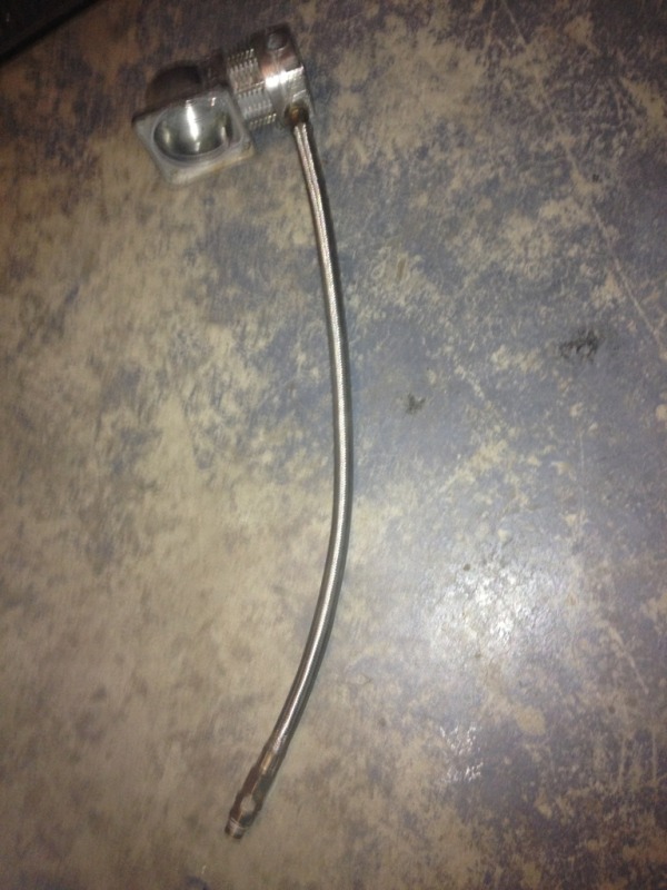

They can hold over 200 psi, on my old s10 when i had viair compressor i had one of them start leak air for the air tank back into the compressor. It should work but i dont know how much pressure it takes to open the valve. I have a old compressor head with the leader hose and check valve on it if you want it to experiment with it. You can have it for free, it should still be good the compressor it came off of locked up.
