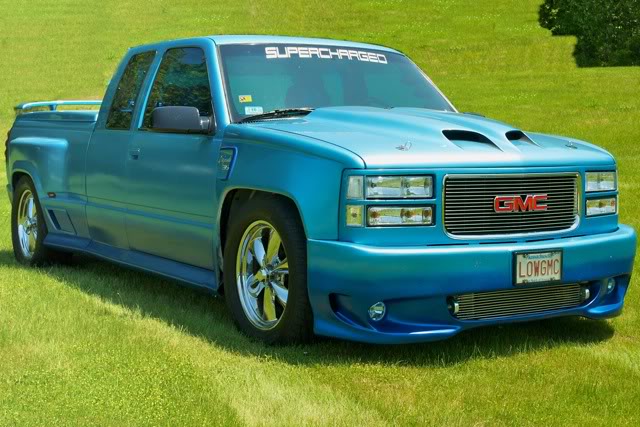

have not been to ned with truck yet....wanted to get the tune right...so I can drive it home.....here is a pic before 22's

Wow a very unique very cool build. What are you using to tune?
