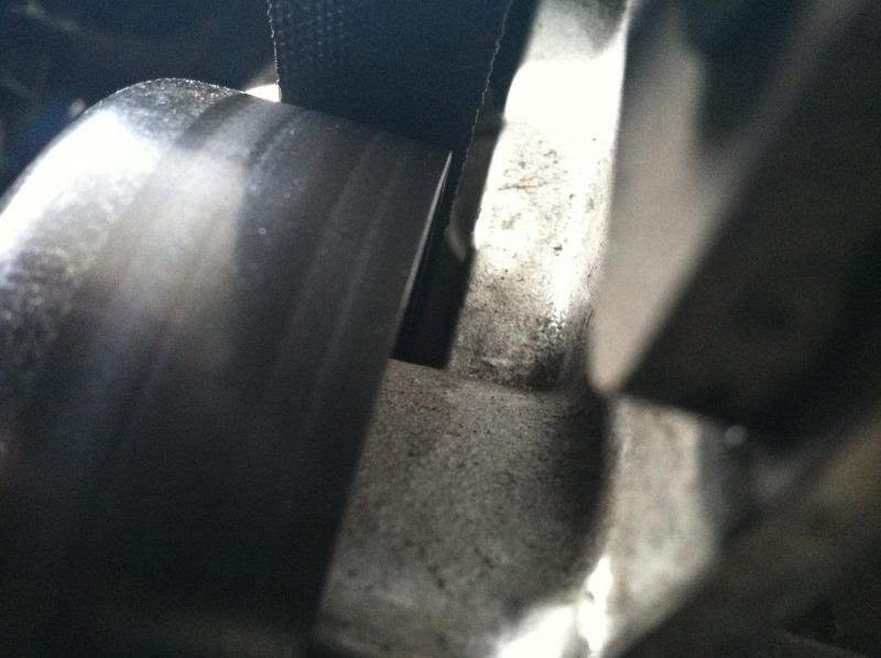

I had same issue this past summer. I also ended up buying another pulley. Any pics? This is how much overlap mine had
I loosened pulley and reset it like 10 times and it stopped being jacked- I must've just got lucky
the pulley with green was the culprit
