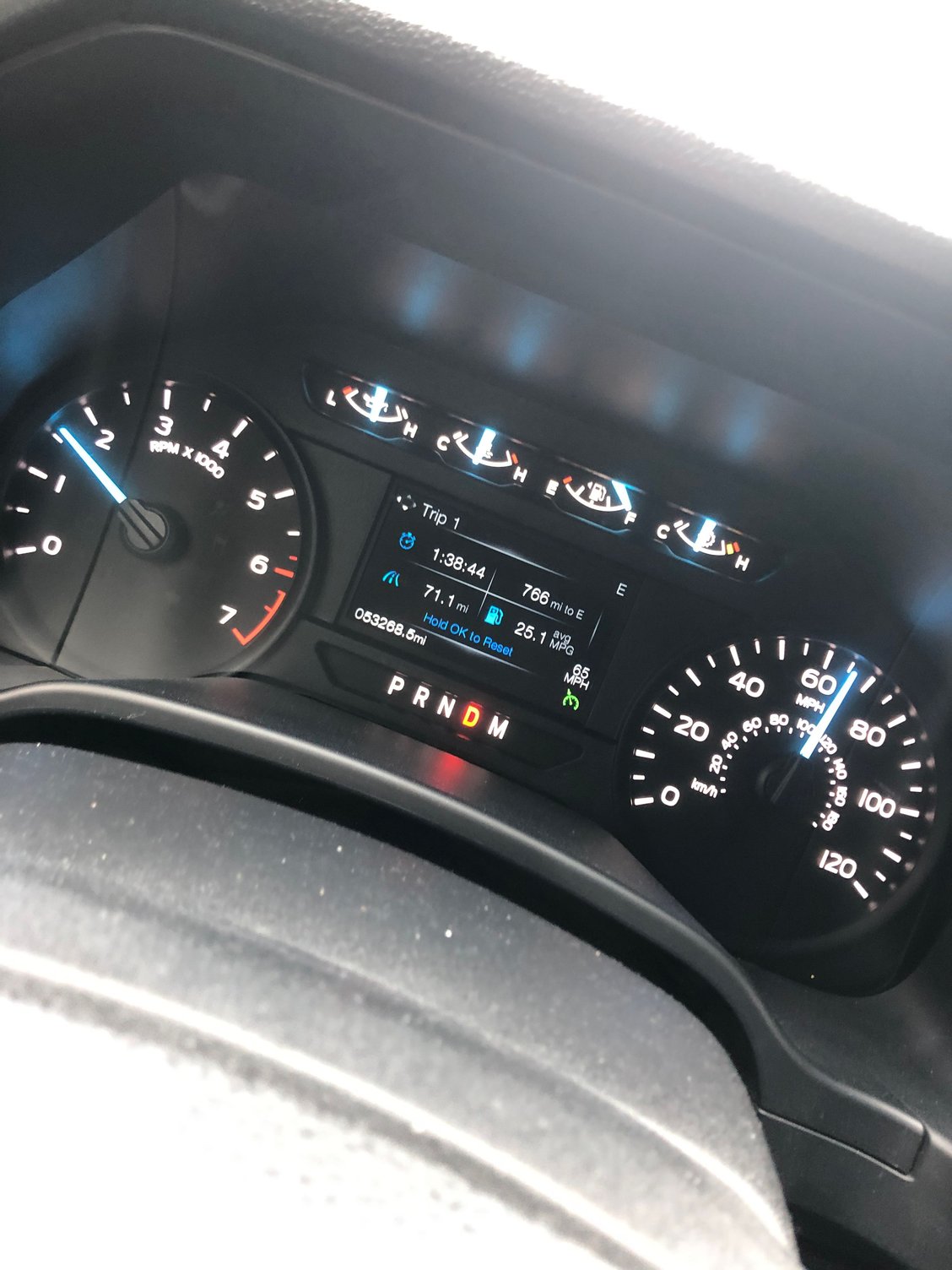

2018 f-150 CCSB 2.7 w/ 3:73 gears and tool box in the bed (100lbs) + 36gl tank.
Been averaging 25mpg with empty freeways during this covid thing. Otherwise I’m around 22mpg.
