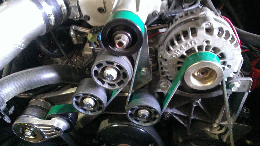

I ended up stepping up to an 8 groove system and placing another tensioner near the snout to increase belt wrap on the supercharger pulley. It worked great and I got no belt slip. I will actually be selling the setup real soon. 2.6 supercharger pulley, 3 extra wide idlers, snout support, alt pulley, pwr steering pulley, 10% OD crank pulley, and the very low mile green gates belt. I just need to get some stuff together and post it up.

does that rub when it gets hot?

No, there is actually more clearance than what it looks like. When the engine turns centrifugal force actually pulls it farther away from the idler.
