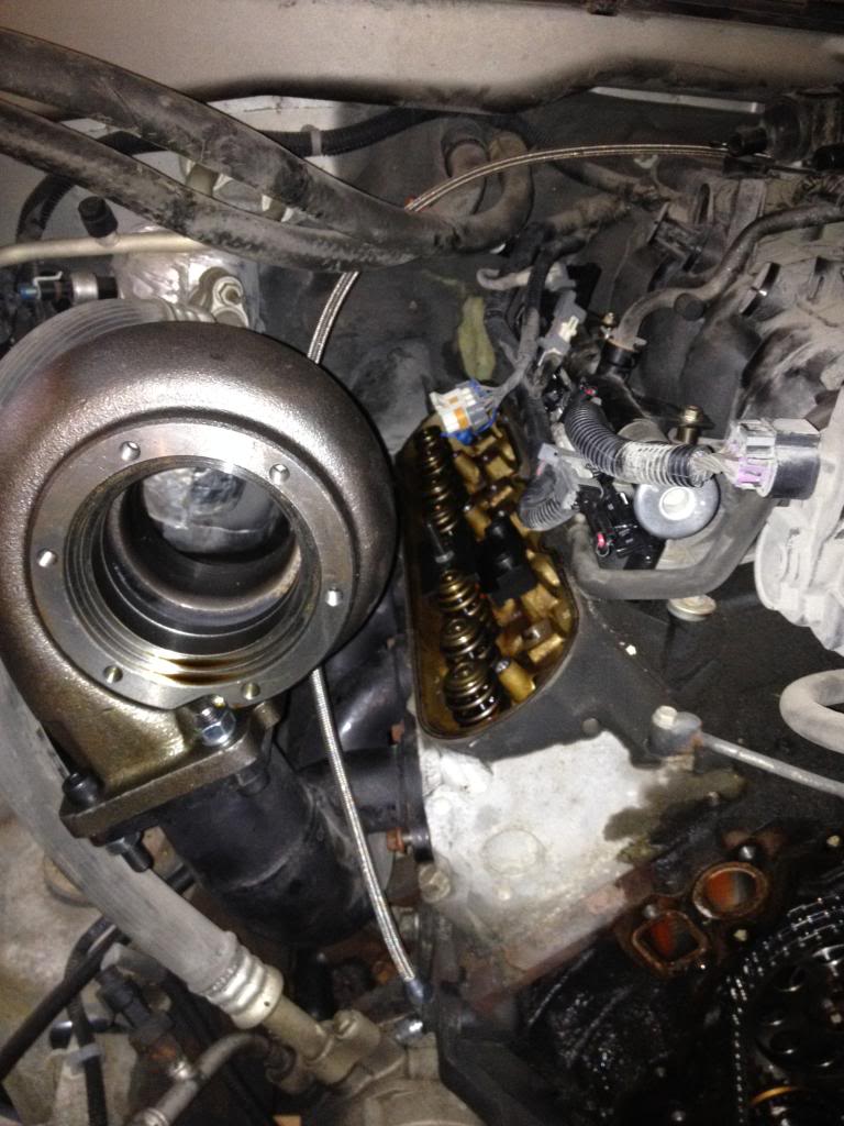

Kb hot side with on3 gt45
This is the older kb manifold**
My housing is 1/16" away from the plastic fill tube...
I have the valve covers off in this pic, but you get the idea!

Pull the fill tube off and just use the cap. That's what I did on my kbracing pt88 kit.

^ Yep! Pull the black tube out of the valve cover, and then just thread the oil fill cap straight into the valve cover.
No issues with melting the cap? Or do you run a turbo blanket?

ill be running a blanket on mine. i also took the neck off
No issues, but running a blanket is a good idea. I've been using a cheap eBay one for about 14 months now on the daily driver, no issues. It smelled bad for the first few trips though.
My ebay blanket touches my cap with no issues at all. Actually its warm but easy to touch and handle.

Yeah +1 on the $40 ebay blanket and take out the fill tube, no issues so far

Yep if you dont run a blanket you will melt the cap...ask me how I know.

I'm running the stock valve cover and the long oil fill elbow and my housing rests pretty hard against the elbow and I do have a blanket on it. No problems with melting.
