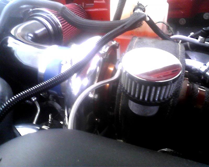

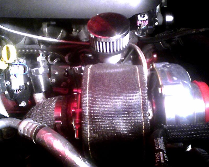

Trick manifold with breather on top of fill tube. Fill tube rubs the blanket, works just fine.
