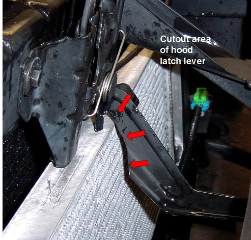

...on the same topic, can someone tell me the aprox. size of the heat exchanger that has to mount in front of the radiator? I have no idea, it may not be a big issue to make some brackets to mount it where I have room.

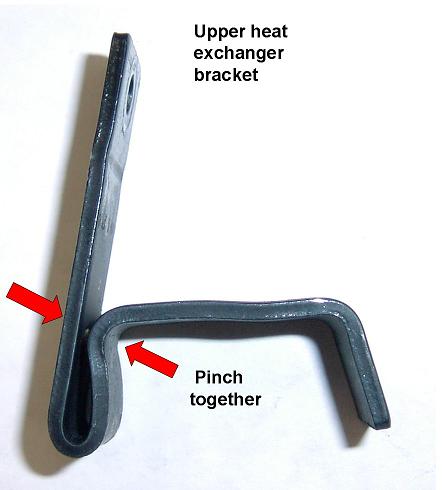

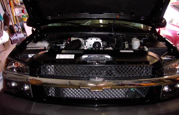

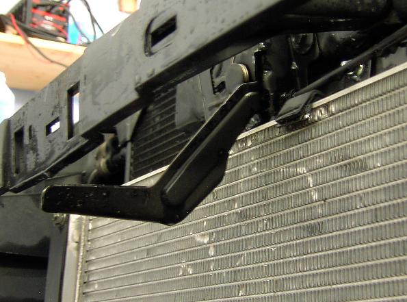

Thanks
Here's some pics of mine. Had to mod the hood release and the supplied mounting brackets for the Avalanche install. Sits in the same place as your tranny cooler. Didn't really want to mount it down low and use it as a skidplate.

Thanks for the pics. Your right, that's exactly where my TOC is mounted.
