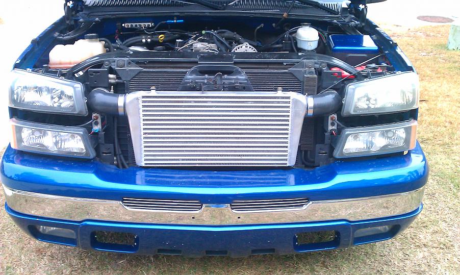

Here is mine. I have had it several ways and can honestly say that boost seems to come in quicker with this setup. You figure when the cooler is behind the valance you are running 8-9ft tubing, when behind the grille 4-5ft. Less distance to travel. I do not notice and cooling issues in the summer with this setup. Oh and it looks better....
