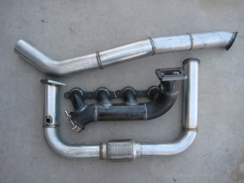

Easiest route would be buy the hot parts from the sponsors on the right ----> Trick or KBracing. Then piece the rest together. Flipping the manifolds is possible but if you want to keep all of your accessories it gets to be a pita. If you have the skills to fab it up Im sure you could look at the above parts and make it your self, which would be a pita since you are in Iraq, or just tell your buddy to buy something from the right.

Yep, I can get you what ever he needs to turbo his truck. Here is what my hot parts kit consist of.
I can add WG and everything up to a full kit. Just let me know what you need.

flip the passenger mani upside down (pointing up and forward) and go at it if you feel the need to fab up the complete hot side. easy. Even easier to bolt up the complete kit from someone else tho.
