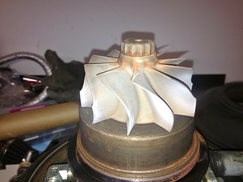

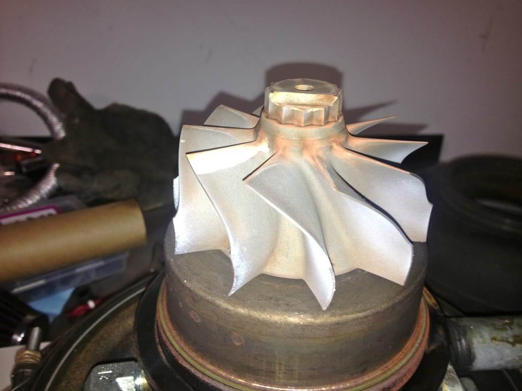

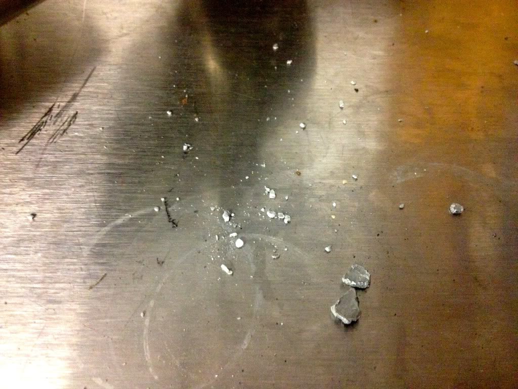

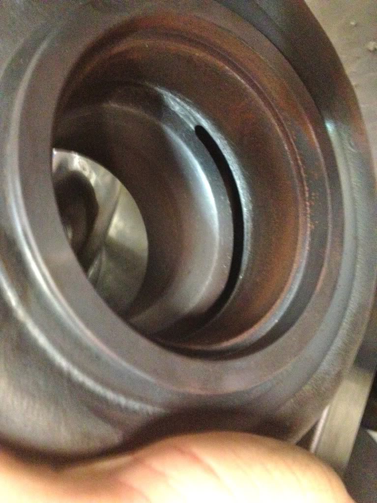

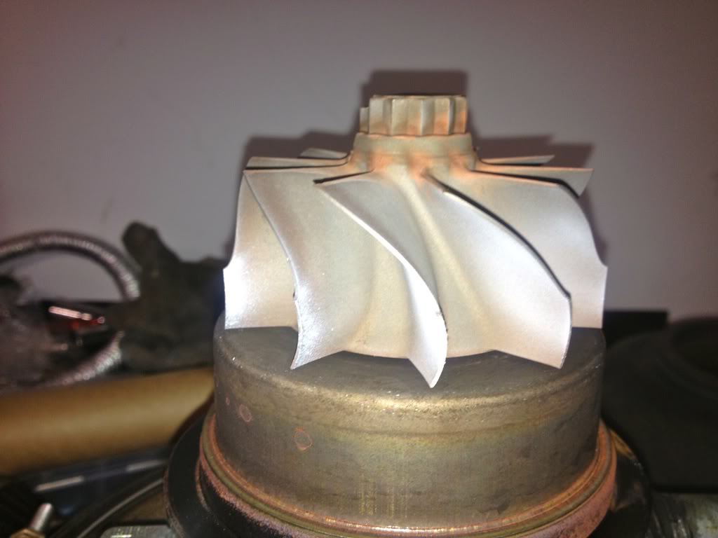

Keep your heads up guys.. The last pull was hard to watch for me to haha, but she kept in enough to keep me safe so still one badass soldier.
Turbo looks ok to me unless someone see's a reason to have it sent in and looked at. It ate some aluminum as i said, but housing caught the larger stuff. Still need to know is the oil feed above the oil filter post filter oiled?
I'm pretty sure it is. Just checked an F-body pan and it's filtered, so i'm assuming the truck pans are the same.

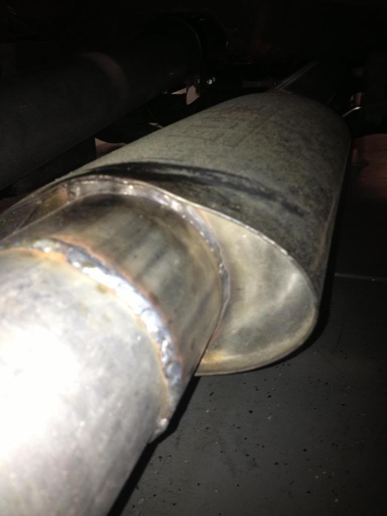

Flow rating of straight thru Borla? I blew thru mine in only a few months, top and bottom... The heck man.

My old s475 ate pieces of catalytic converter and lived Those b-dubs are tough!

The wheel looks OK from a pic, but you can't tell from a pic. If the blade touched the housing at all, you will need to send it out and make sure it is still balanced.
