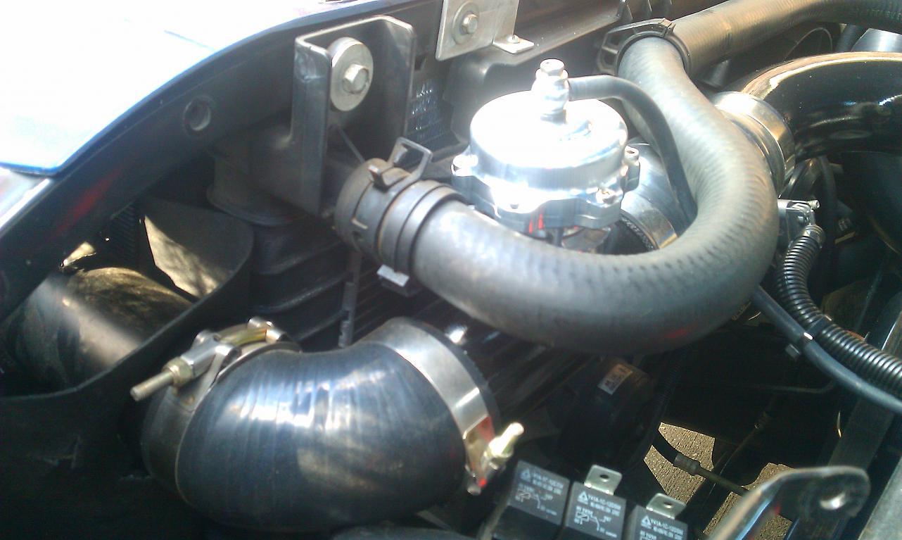

best i have available
2 1/2 inch pipe. other side is basically just like the side you can see at that height

Where did you put it through? I have a bunch of AC lines and stuff blocking any place to route it? Did you move anything?

trimmed some plastic, are you talking about the line between the radiator and the pipe?

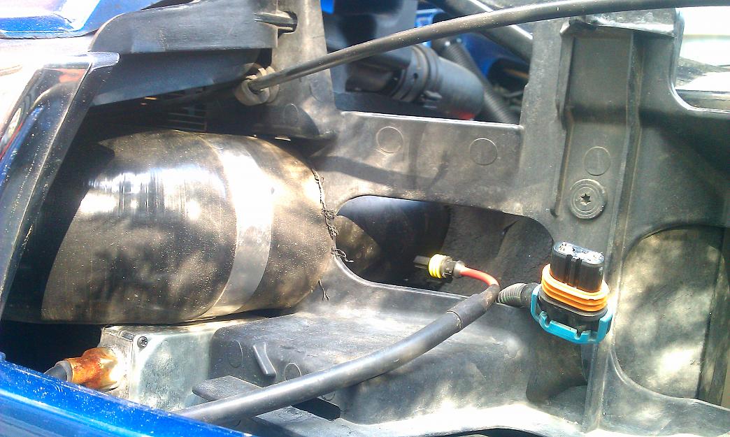

hole saw a hole thru the headlight bracket and ran it around.

My IC pipes are routed very similar to Supra's and they are 3" from turbo to the TB. If you are talking about the AC lines on the passenger side, I cut a hole through the plastic headlight bracket but left the hard plastic in front of the lines to protect them. I took some pictures while I was building the cold pipes but I decided to go swimming in the ocean with my iPhone on spring break
