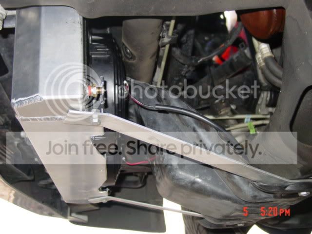

yeah i have dont this to my fluidyne, but weather you a2a or a2w it should look similar

well i couldnt tell you about temps , i installed these fans when i installed the fmic right off the bat. i have the fans come on with my engine e fans. temps are 10 degrees above ambient in hot weather and only a couple in the winter. i have a manual switch for them and if i leave it on they will get almost exact as ambient. but the switch also turns the pump on. the fans help more in stop and go traffic or when the truck is getting good air flow.
the cool thing about a2w is you can put in an ice box and get way sub ambient temps. one time i dumped about half my ice box full and i was 10 below ambient which is like 43 degrees on a 52 degree night and the differenc it made was alot from sotp. if i had added more ice it would have been even colder. for a truck used at the track often i recommend an a2w set up . for a DD a a2a is nice because it wont suffer from heat soak as bad.

I don't think that with a A/A it would be worth it. A/W maybe, to help fight heat soak but thats it. With A/A, might make it a little cooler then not moving, but who cares if it's a bit warm then, as soon as you start moving, it will cool right off. They will probable be more of a restriction at speed also.
