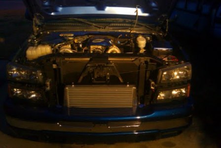

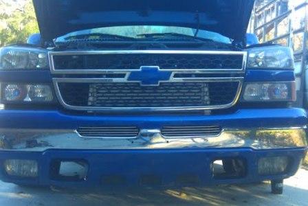

here is mine, it about 31x12x3, very tight fit but it looks good I think.
Attached Thumbnails Fmic>>>??-new-intercooler999.jpg   Fmic>>>??-new-intercooler-11.jpg
Old Mar 4, 2010 | 07:00 AM
Raffman's Avatar
Posts: 637
From: New York
Do you think the 4" version would fit there or have clearence issues?
