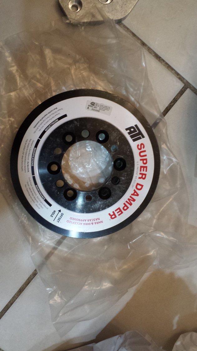

Just a quick question I got a f1a with hob bracket and all I need is the ati balancer can any one help me with a part number I will be running it on my lq9 the Procharger comes with the 8rib pulley I need to bolt to the ati balancer just not sure which one

917286 is the one you want

Thanks blown that's what I thought but wanted someone to verify

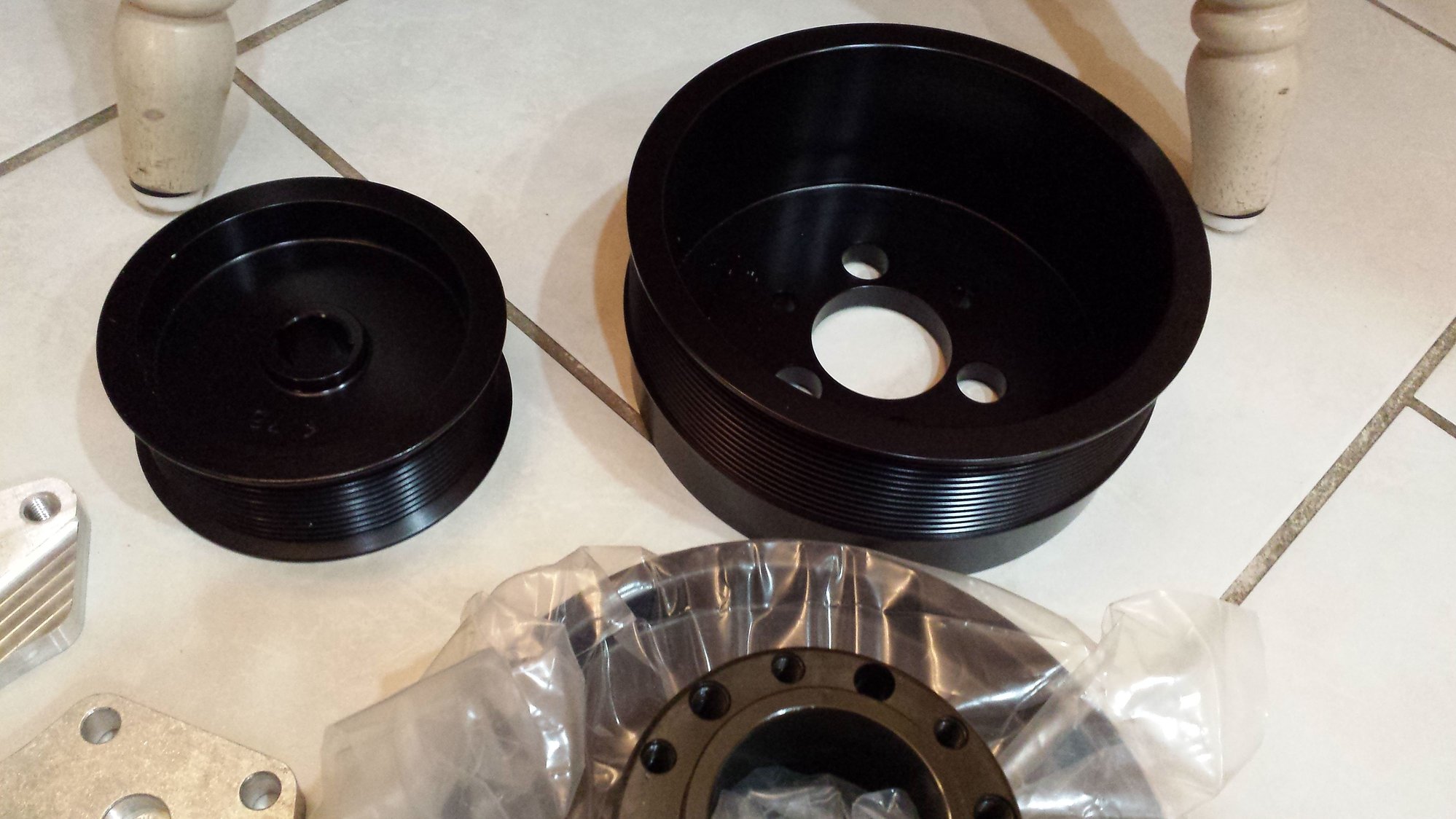

Have a HOB kit too. 12 rib crank pulley for the ATI damper is for a 2010 Camaro from Procharger and I believe is 7.63" in diameter. Don't know about a larger diameter crank pulley. Maybe contact HOB.

Does the 12 rib pulley from HOB have 3 or 6 holes in it? Another option is the camaro pulley with the 6 bolt pattern part number 918635.
3 bigger holes, 3 little holes. See pics.
