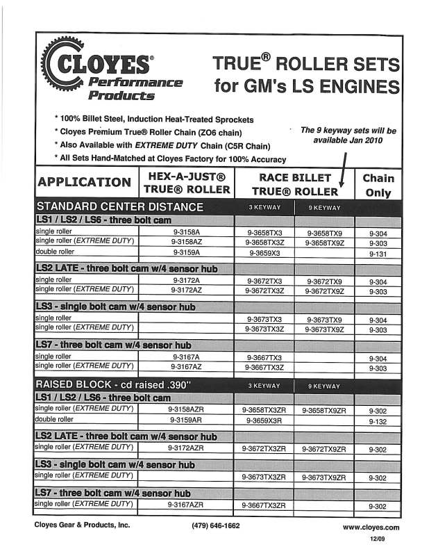

Originally Posted by gamble686
Hardened pushrods is a good idea when spinning the motor higher than 6400 rpm. I believe the tooley rods are the cheapest now@ $90. Also a stock 4.8 with a lot of miles most likely has a very loose timing chain. The ls2 chain is a cheap upgrade.
Why LS2?
Old Jul 23, 2013 | 07:52 AM
  #23
fastjweb's Avatar
Joined: Feb 2006
Posts: 1,089
Likes: 19
From: NewBern NC/Lake Havasu City AZ
The LS2 is a stronger factory replacement and they are pretty cheap.
Old Jul 23, 2013 | 03:02 PM
  #24
Kingsize's Avatar
9 Second Club
Joined: Jul 2007
Posts: 240
From: Baytown, TX
Agreed... The Cloyes LS2 single roller is a hard bang for the buck to beat, otherwise they offer a Hex-adjust single roller with the C5R chain for an extra fee. Cloyes is the OEM supplier for GM by the way.

Old Jul 23, 2013 | 06:03 PM
  #25
TURBHOE's Avatar
12 Second Truck Club
Joined: Nov 2004
Posts: 6,318
From: Jacksonville FL.
05 and newer chains should all be just like the ls2 chain. ls2's are just the first ones that got the upgraded chain.
