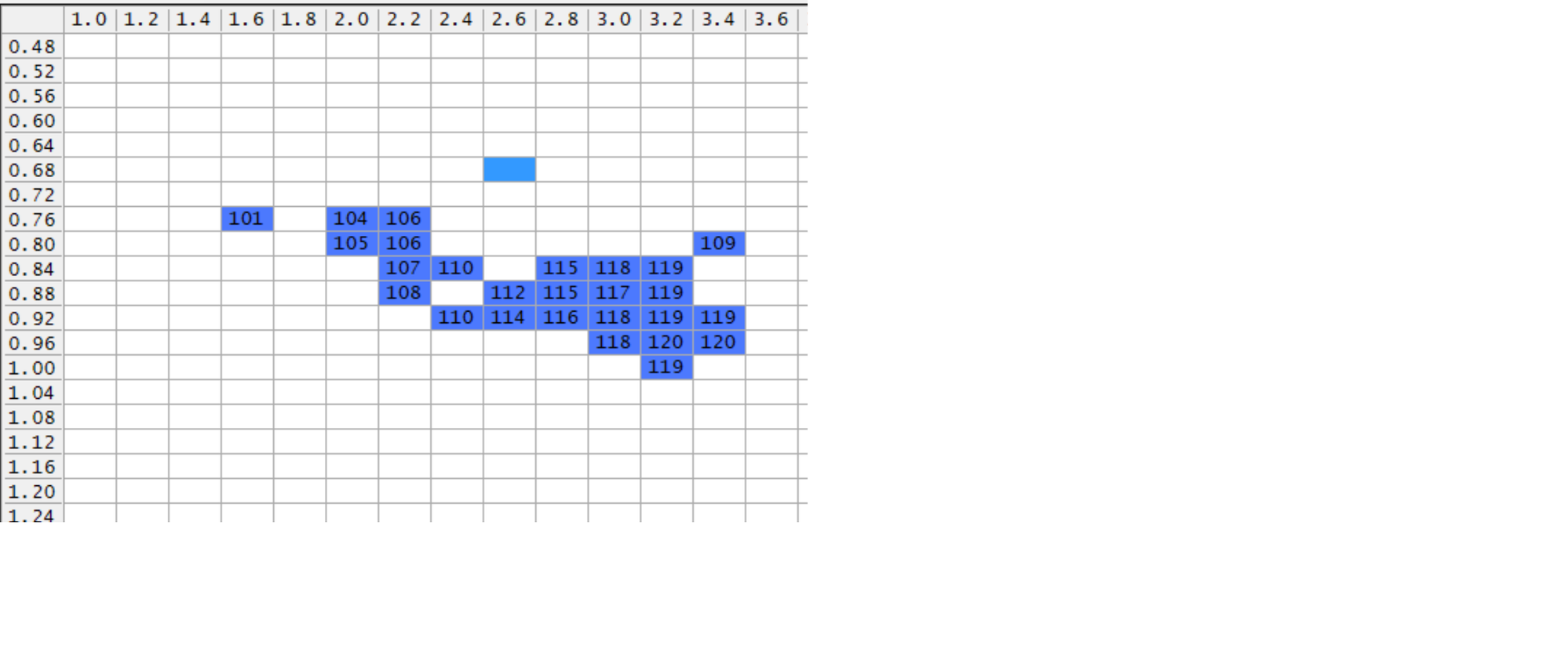

I'm not sure that I should be getting into this much boost so soon. Below is the filter I'm using in the scanner to determine how much boost is coming in when against my timing advance. Pretty sure how low it's coming in I need to upgrade to 4" piping. 3.5" at least 😂
(MAPkpa-Barometerkpa)>0
([50030.91]-[50032.91])>0
