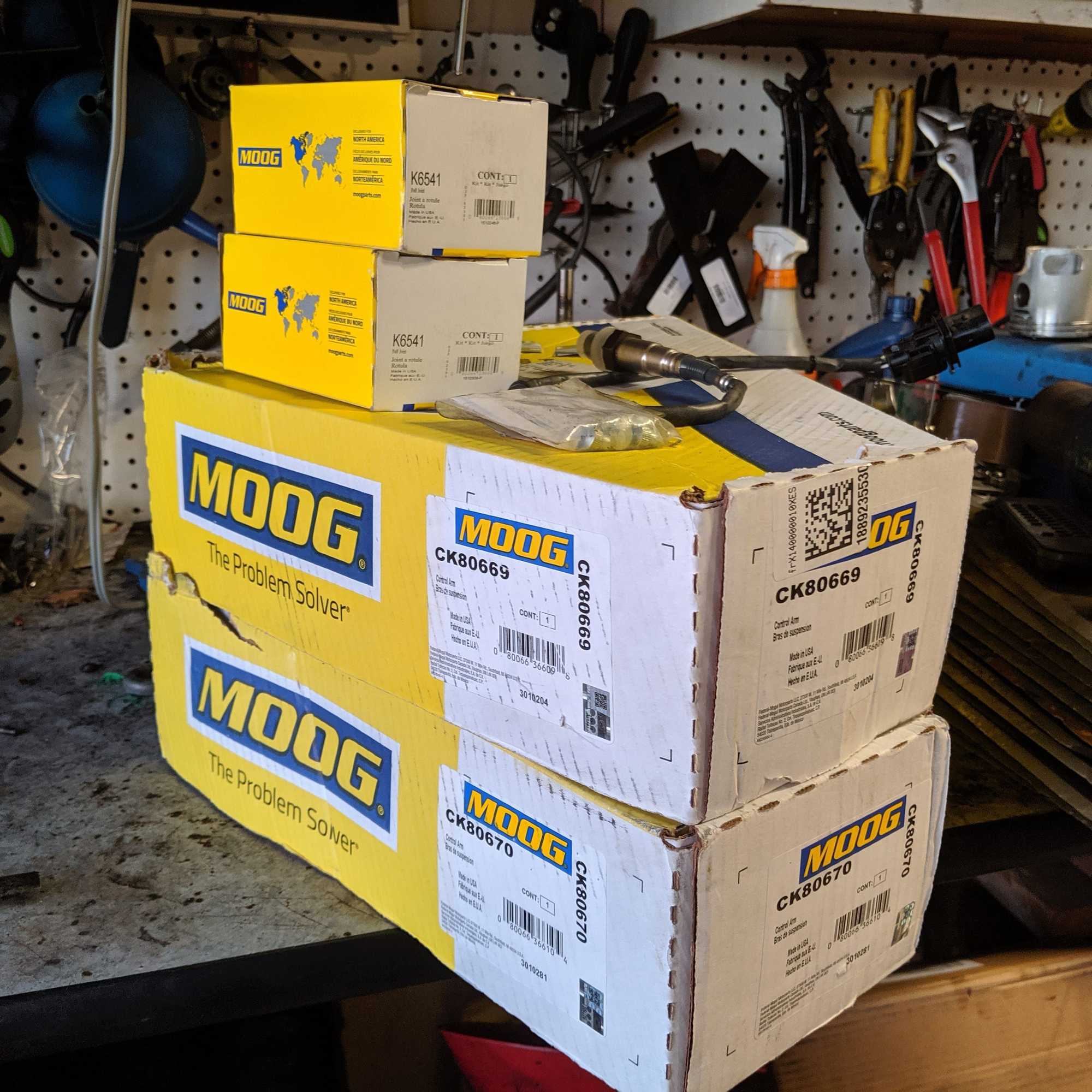

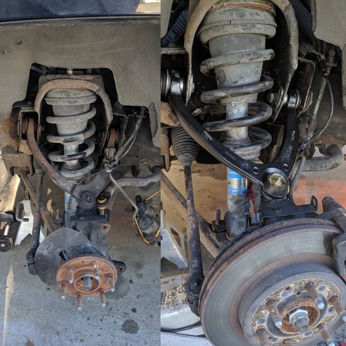

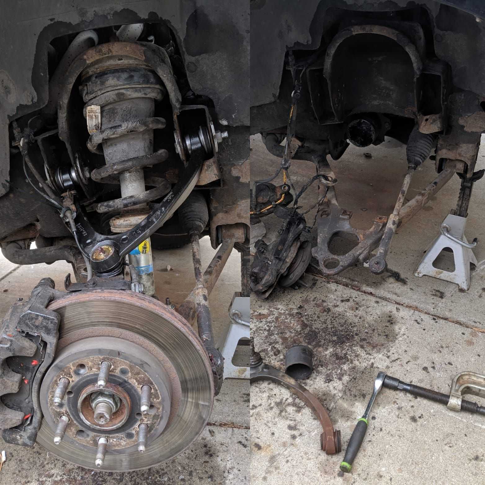

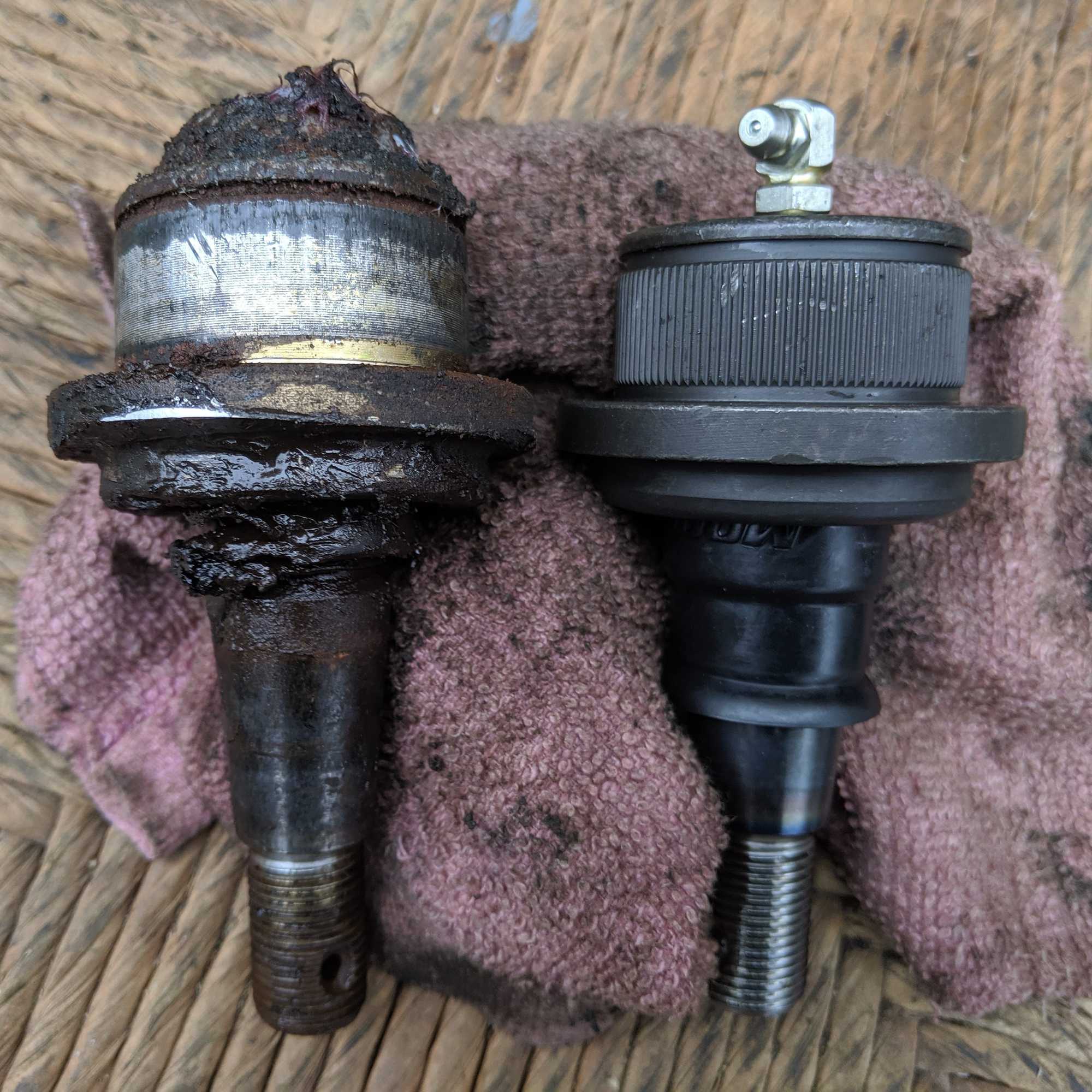

Rebuilt the front end, again, while I'm waiting. I originally did UCA's and LBJ's at 100k, and LBJ's again at 195k when I did the Bilstein struts/shocks. At 209k, UCA's had worn bushings but UBJ's were solid. LBJ's were BAD after 1 year- one was so worn my pickle fork almost wasn't thick enough to pop it off the knuckle. I also either got hosed on the moog LBJ's last go round, or they updated the parts. Same part number as I reordered from Amazon.
Bright side is intercooler, piping, boost gauge with pod, and vacuum manifold are waiting under my workbench to be installed.
Supposedly same part number for both....
Passenger side
Drivers side

Try having a Silverado SS that is apparently a unicorn for Moog parts. I will admit I was an idiot to not take my parts with me to verify and instead verify when I got home. I just did inner/outer tie rods and both wheel bearings and it was mind numbing! Sucks when there are like 3 different P/N's for the same component that all "fit" the truck. Sorry had a flashback when I saw all those Moog parts lol.

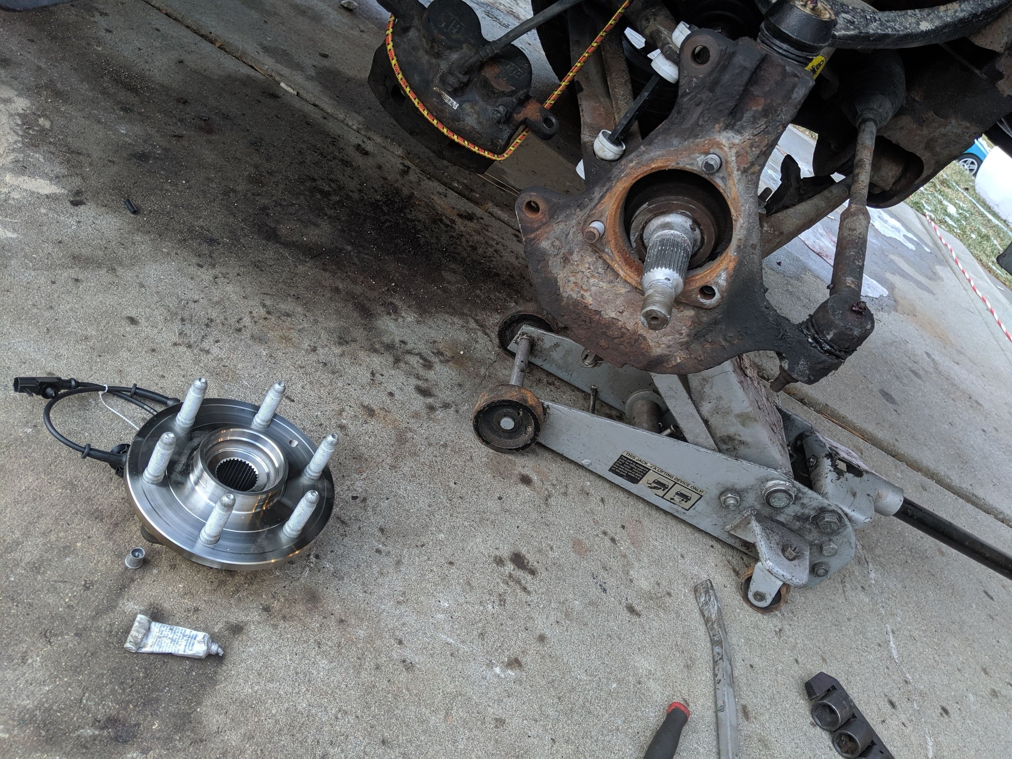

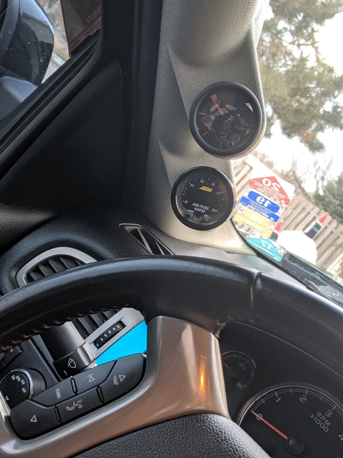

In the meantime, got some more work done. Found a bad wheel hub. Timken made it about 70k, OEM made it 130k. Ordered SKF. Disappointed in timken longevity. Ordered the other side as I'm sure it's not far behind, and what happened last time. My 05 Colorado made it over 400k with a lift and 20's or 31x10.5s on OEM front end components- hubs, bj's, tie rod ends.

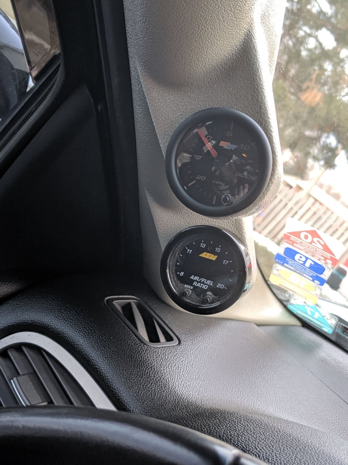

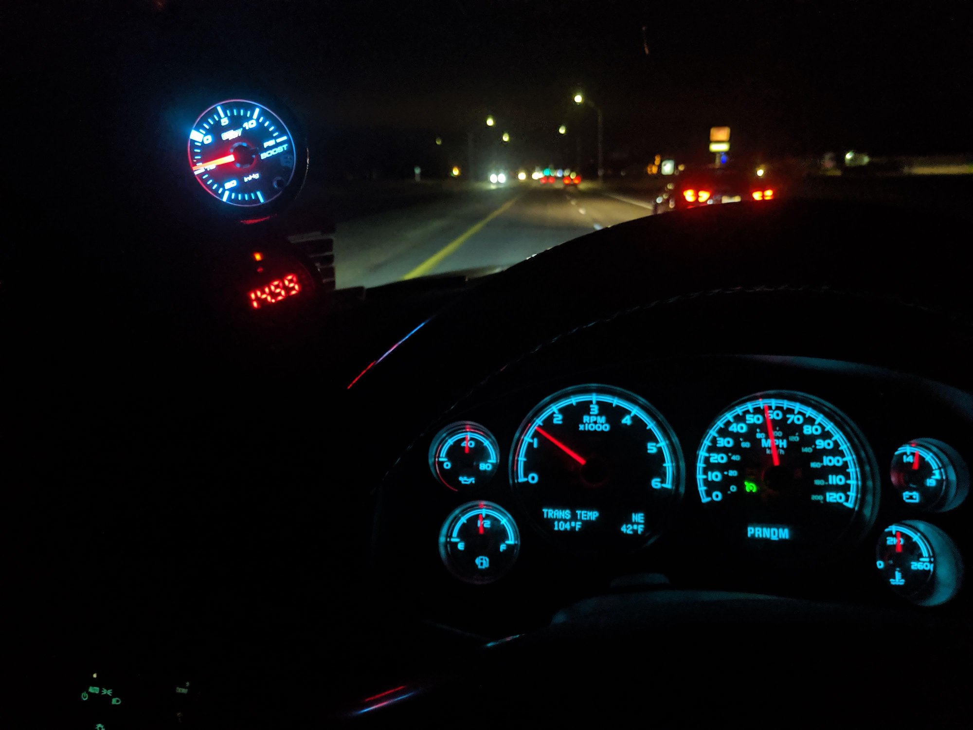

Also got the gauge pod installed, and installed my boost gauge. It is nice to not have my wideband rolling around in top of the steering column anymore. The screw glowshift provided was too long but I fortunately had a spare 3rd Gen Camaro screw that was perfect after adding a couple washers.

boost gauge is busted, its pointed the wrong way
Old Dec 22, 2020 | 10:07 AM
  #27
HawkZ28's Avatar
5 Year Member
Joined: Feb 2018
Posts: 187
Likes: 25
Amen! 😂

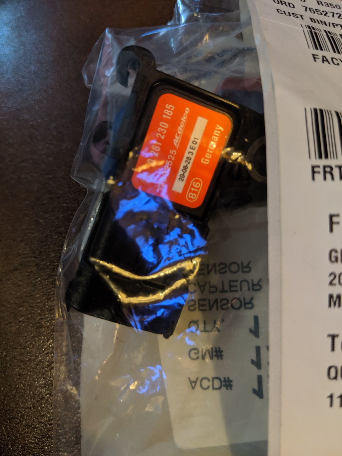

2.5 bar MAP sensor arrived...

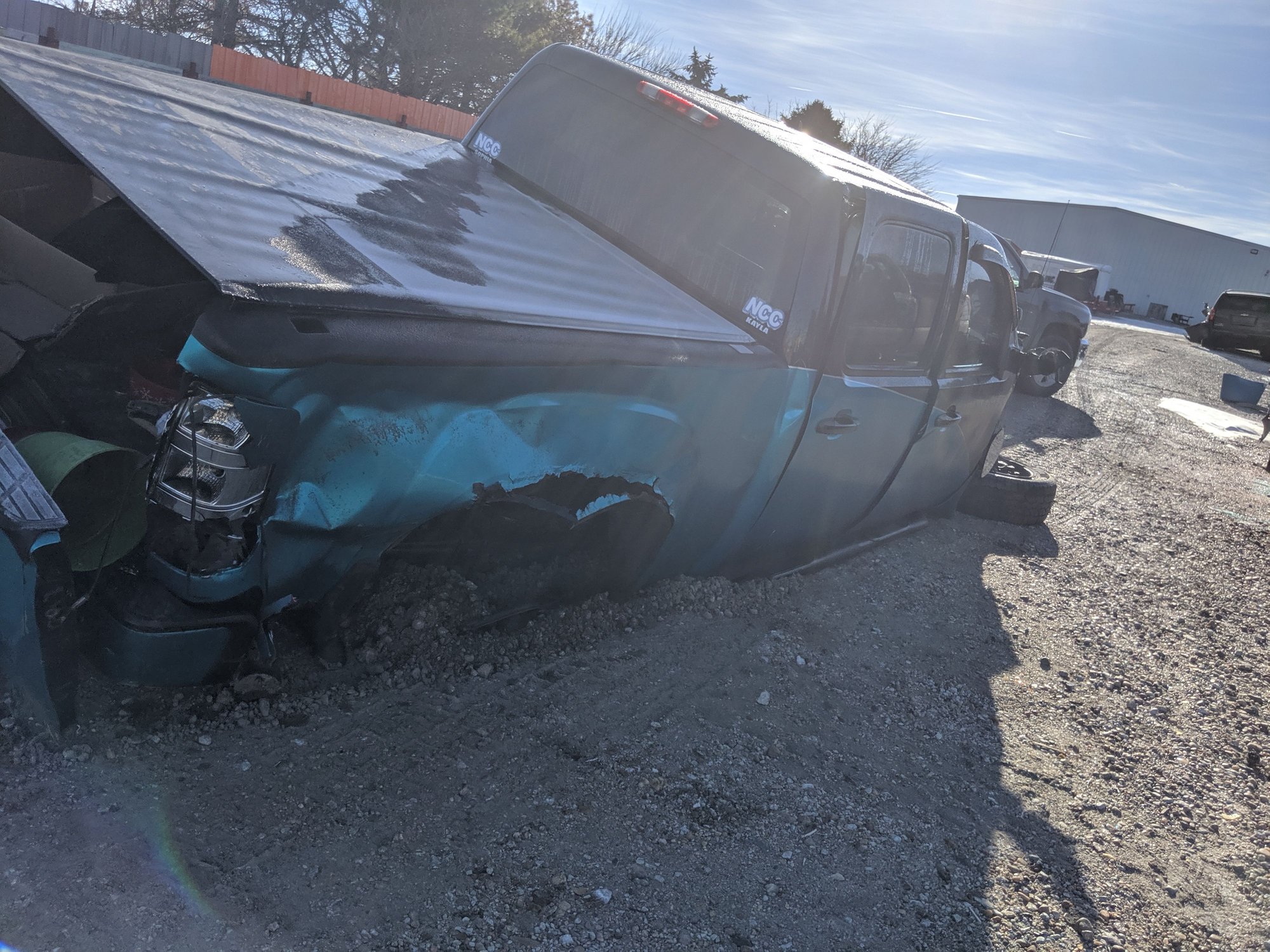

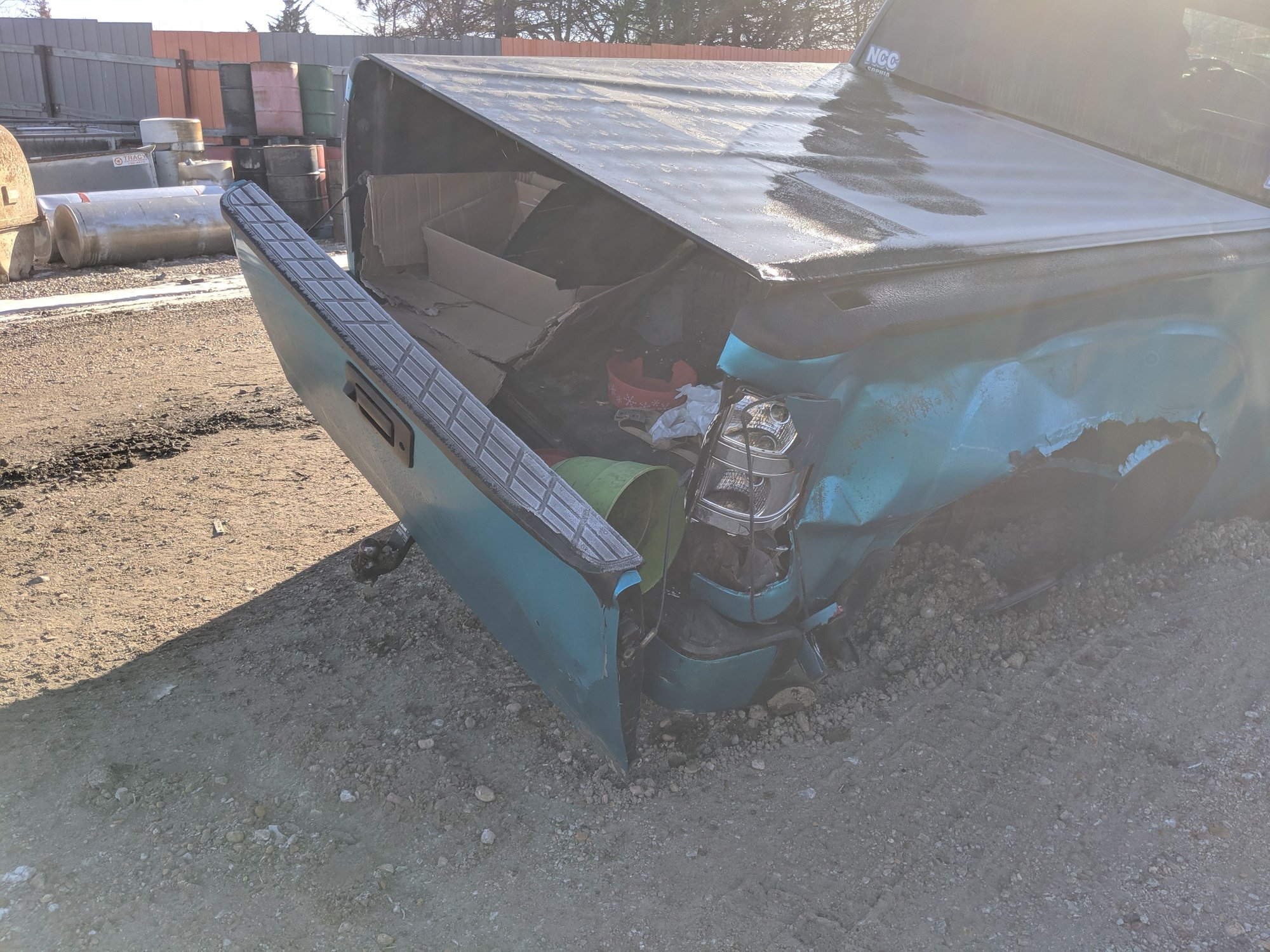

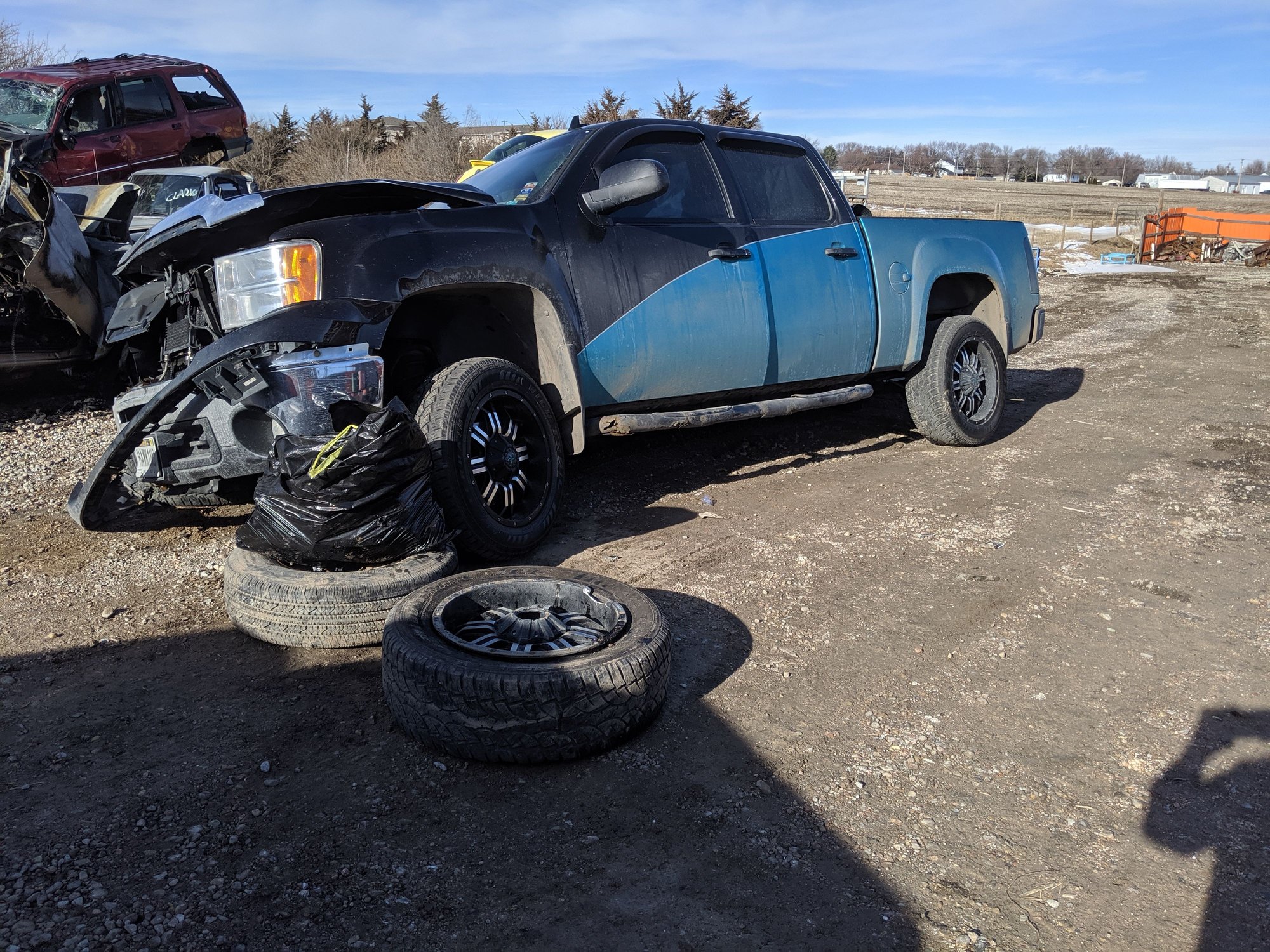

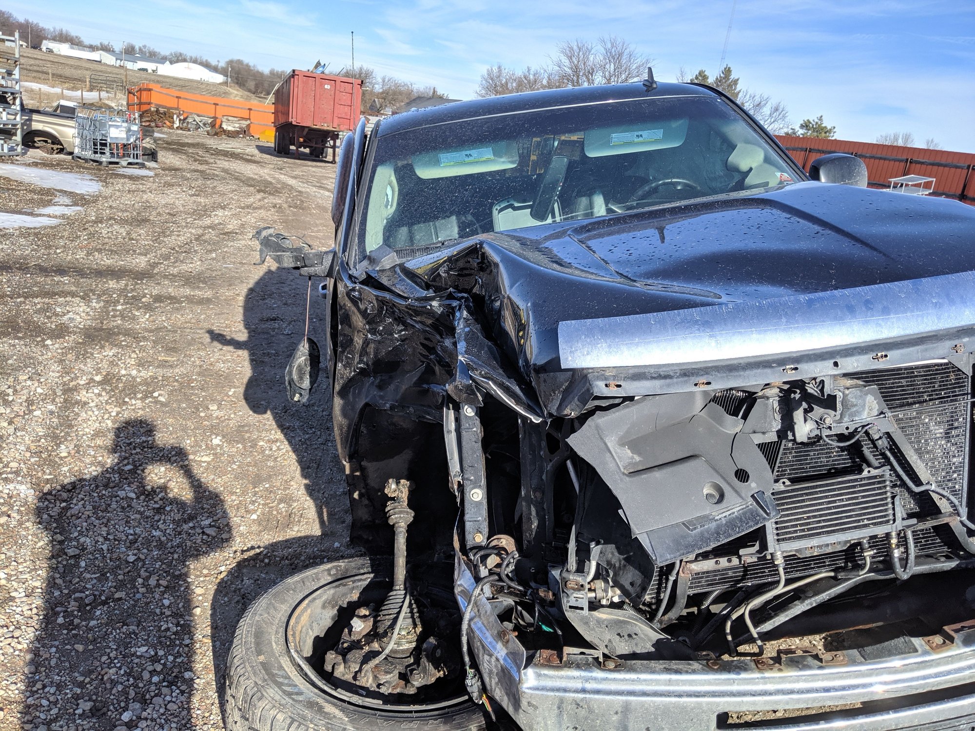

Project for this truck is done prematurely. We got hit on a gravel intersection on my way to the inlaws Christmas day. The important thing is we're all ok, thank God. Sore, but ok. The truck did its job keeping us safe.
I'm going back later this week to get what parts I can off the truck- really just the procharger bracket and gauges. Maybe the PCM and UD pulley. Pretty sure the passenger header is crushed, truck is sitting on the mbrp exhaust, K&N cai is probably smoked, B&M supercooler looked sketchy. Not looking forward to getting a truck that hasn't been cam swapped already and the gamble of stock valve train.
