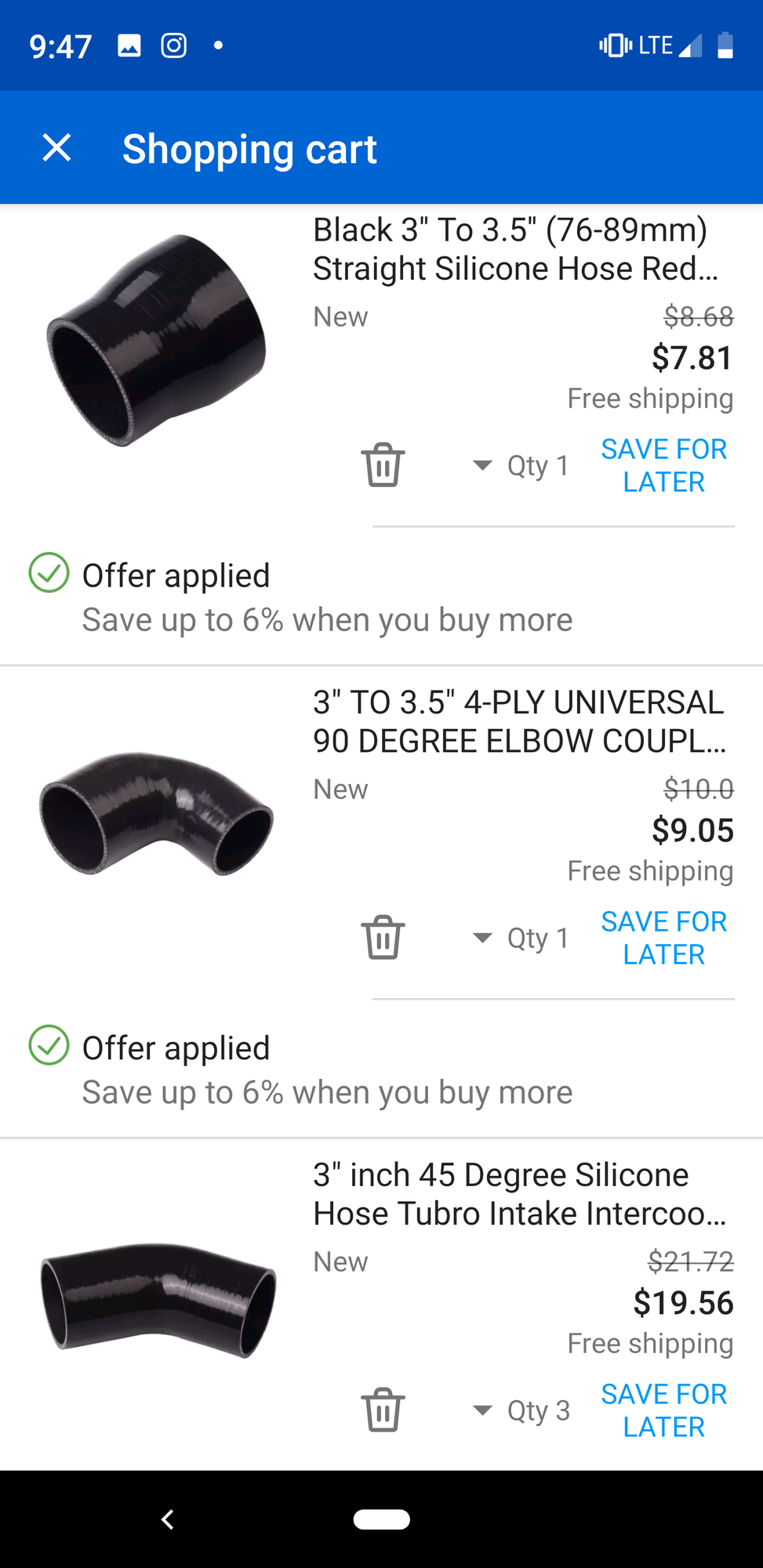

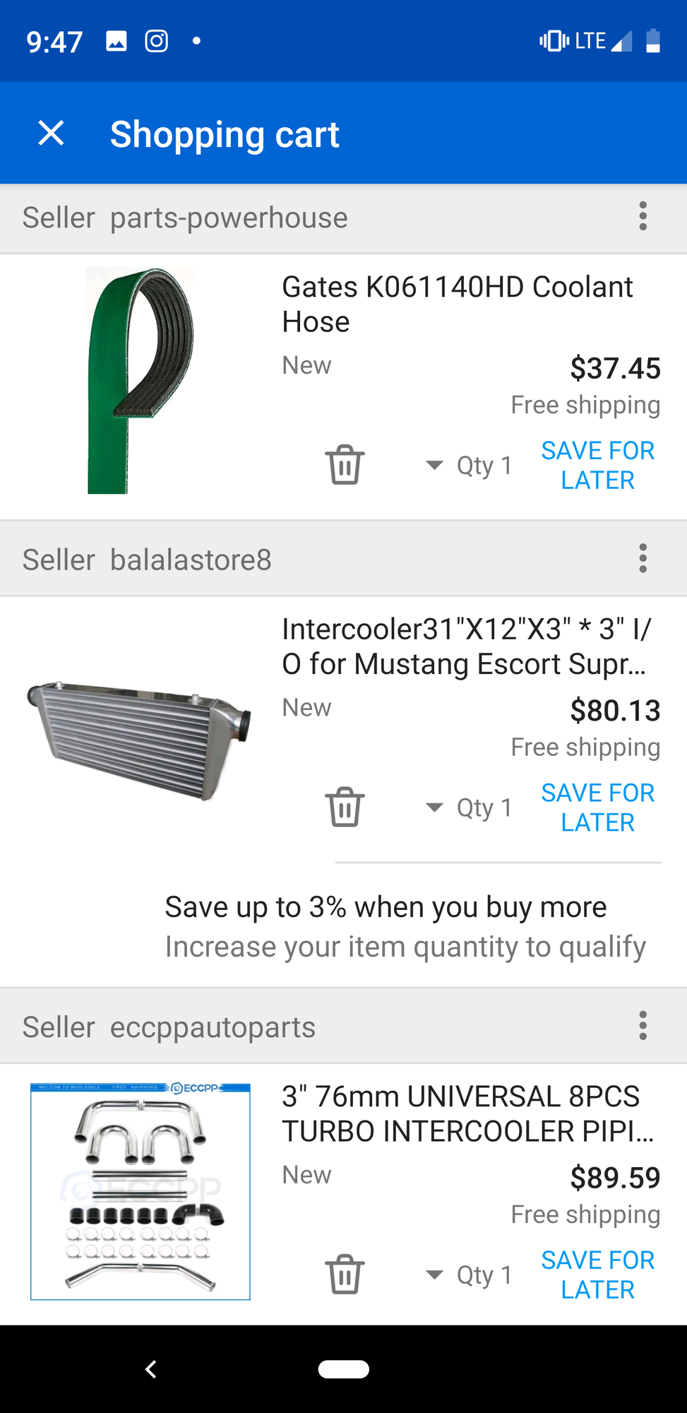

My shopping list are above. Does it look like I'm missing anything?
I already have the 3.8 pulley, bypass valve, and brackets arrive Monday from a member here.
Had to break $150 for free shipping at brute speed. Was at 141 or so, shipping was $72! Might change the shirt to one for the wife
