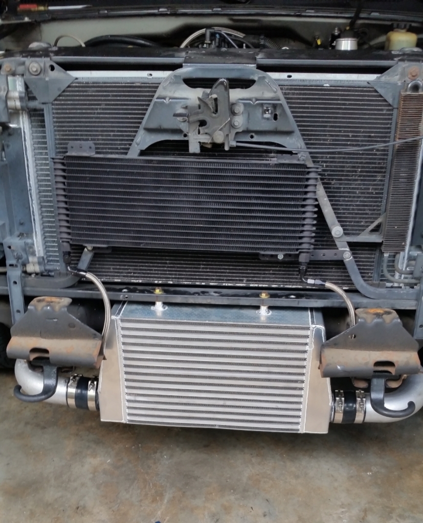

For any poor soul that cares, I got the intercooler installed. It went well. I could have fit the 6" thick core however, the lower valence would need to be hacked.
I'll be heading to the track Friday. Weather outlook looks great for now, high of 86 low 59.

Looks good! Where did you get the end caps from, Garrett as well?

Looks awesome!
Is this the 4" core? Why not shift to 4" piing as well?
The IC was custom built by Robert at Chieseled Performance.
Core is 4.5" thick. Cold side piping was already what I have and also 4" isn't needed at my level.
Went out to fill up with race gas for $1.65/gal...gotta love E.
Good 3rd gear romp on the highway saw an 8 degree temp rise. Truck still feels slow .
