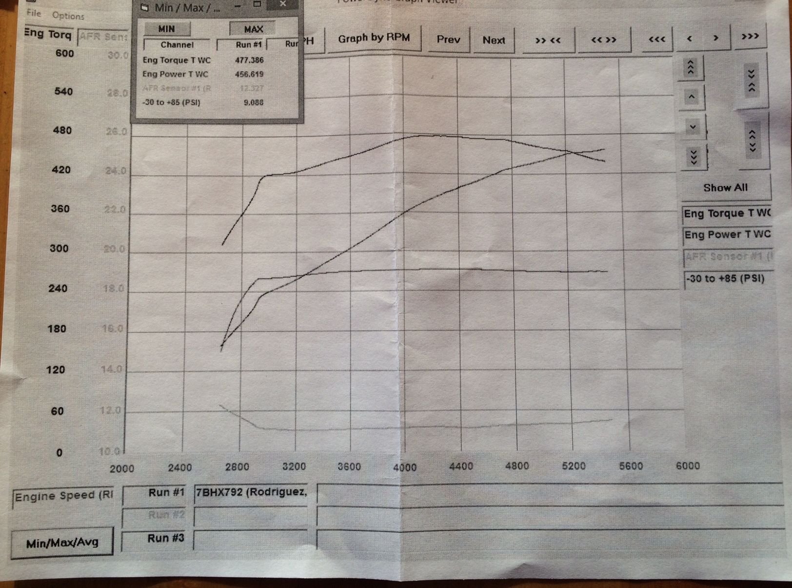

I don't have a MAF on the truck. If you guys are thinking that the heads and cam aren't holding me back, then it might be the boost controller or my wastegate spring? I know that before we changed the mechanical spring value in the controller, the truck fell completely on its face at 4800. Truth be told I'm still confused by what settings to enter on this Innovate SCG-1. This is my old graph from dyno session #1 (13 degrees timing). Granted, I did have a miss that we discovered while on the dyno and on the way home I did noticeably feel it under low rpm load, tuner said it was breaking up but in hindsight a big part of my problem was likely that my boost controller was probably kicking in. I did fix my miss before dyno session #2...

I don't see any evidence of spark blowout in the graph.
My advice regarding the wastegate would be to disconnect the boost controller and get a steady base boost level on spring only. If your WG is undersized it could wreak havoc on boost control
So with a 9lb spring in the gate (46mm Precision) it should hold pretty steady at 9psi, and if boost creep past 9psi occurs, then the gate is too small?

Boost should hold relatively flat. It's not uncommon to see 1-2 more psi in high gear. But it shoukdnt be spiking.
