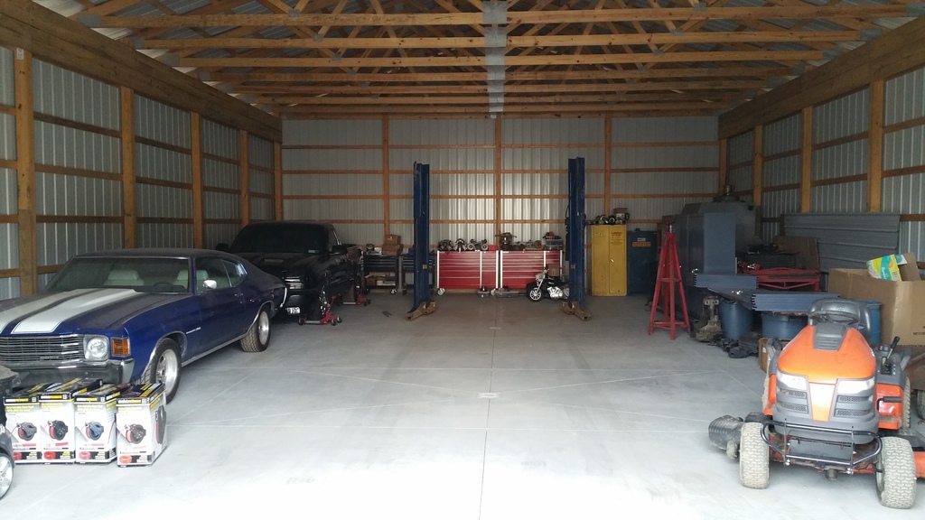

I feel bad about not getting the truck done, but the shop makes me feel good. Here's a pic when it was cleaner. Now it is insulated.

great shop. wish i had a space like that

Thanks, I should have done it years ago, but glad I waited.
