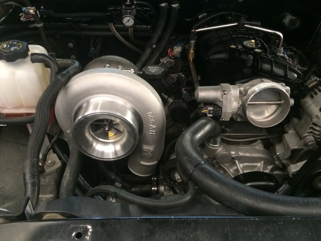

I run the cap on my neck and run a filter off of my valve cover like this. You can see the filter in between the throttle body and compressor housing. I'm not running a catch can though. I just run filters on both covers.

That filter on the valve cover port will work perfect. Pretty sure that is a 3/8's barb on the pass. side valve cover. I will get one coming. Thanks.
