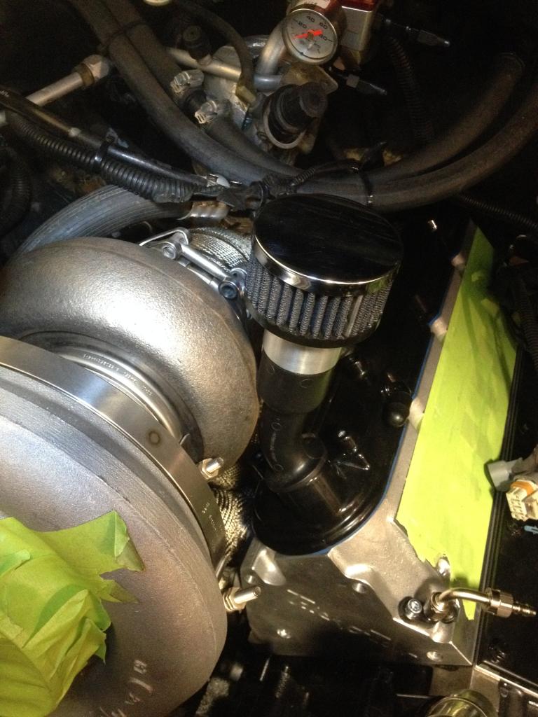

I am getting close to firing up my new setup and I am trying to narrow down a few details. Bare with me, I am using my phone to post this.
I have a s480 going on my 408 and I am using a new set of kbracing hot pipes. My old setup was running a MP t-76 with kyles old pipes and my breather fit great. So fast forward to now and the breather doesn't exactly fit well.
I am changing my catch can setup from a non vented to a vented setup with a #8 line from each valve cover to the vented can with a line from the turbo to the can also. So my question is, is there a direct bolt on filtered breather that will clear the turbo? I haven't even put my blanket on to my turbo and it is already touching. I have considered forcing everything together and hoping that my blanket will keep the turbo from melting the full tube but I don't know. My breather I have now is a Casper breather on a TBSS filler tube.
Any ideas please let me know.

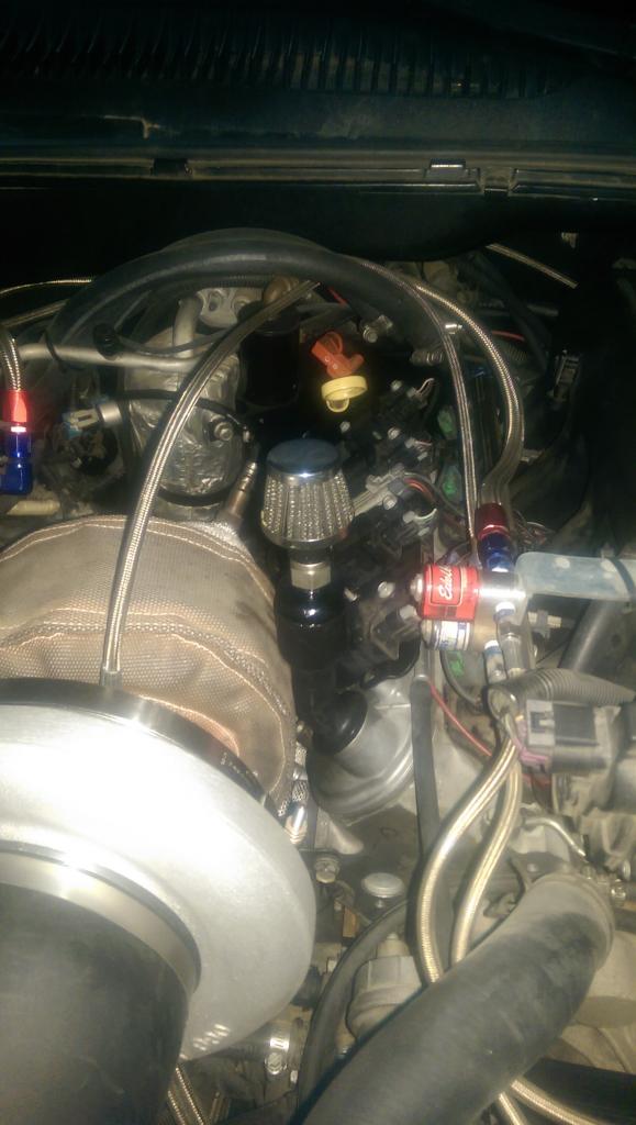

Originally Posted by AkSSS
Are you running a filter also or just the lines to the catch can? And are they 10an or 8an?
Just a filter.
