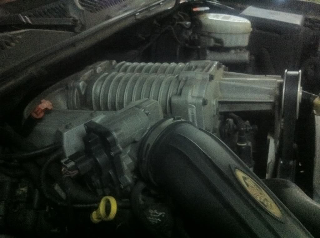

There are two port on side one for brake and the other for what Name:  f5c9baee.jpg
Old Feb 12, 2011 | 07:59 PM
AKlowriderZ71's Avatar
11 Second Hall Moniter
Joined: May 2008
Posts: 11,651
Likes: 10
From: Wyoming
Ok, look for a small brass pipe plug on the left rear corner(driver's side) of the lower manifold. It's back there close to the firewall. Remove the plug and install a new nipple for your vacuum hose. It's a 1/8" NPT thread.

AK is correct it is next to the fpr port. Just did one on mine.
