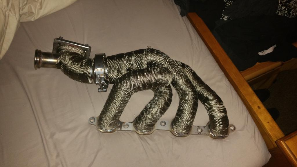

That's crazy! I even went back and looked at your build thread to see the placement of the WG's, and everything looks good to me... Are the WG on a 90 off of the exhaust manifold or a 45? I couldn't really tell.
It looks to me like they're on a straight 90, after the bend up to the turbo... Maybe if they were placed coming straight off the bend it would be better for releasing the exhaust gas/flow? That's the only thing i can think of... The WG's are definitely big enough.

After seeing that pic, it looks like it should be golden! I honestly have no clue what else it could be though... But I know that going from 7lb springs to 3lb springs, you should not be seeing the same amount of boost! It seems like to me if you took the WG's off you would still see it climb to 7lbs!
Man that thing is gonna be fun to drive!

Yea I think I should take the gates off just to check them out to weight out all options

That's what I would do, and if boost still climbs... It's gotta be the WG tube/flange placement.

Yea but where would I move it to I mean can't really get to much more in the line of flow.
