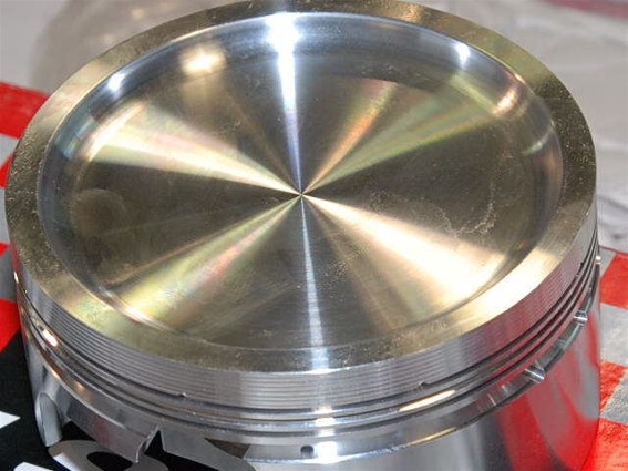

Would you add any advance if going with a static CR below 9:1?

I wouldn't set something up with that low of compression, but either way I wouldn't advance it. You have alot of cubes to make up for the lack of torque. You also aren't concerned at all about how well it drives around or you'd have compression higher than 9:1.

I believe we are looking at 8.8:1 with these pistons/heads. Which is about the same as the stock 454 in my old K2500 HD Sub. At least I will see be over 1000lbs lighter than it was, and any lack of throttle responsiveness will be limited to the first few mm of pedal travel.
