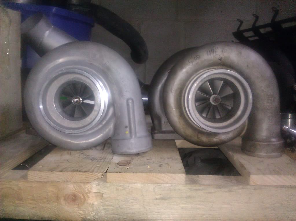

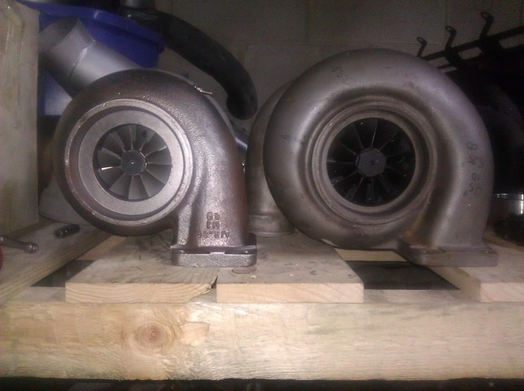

Well lil update i swapped my 8101 with a 7101 and found some .96 exh housings
truck spools much better now
Old Feb 24, 2013 | 02:38 PM
  #88
xx_ED_xx's Avatar
Joined: Jun 2007
Posts: 2,229

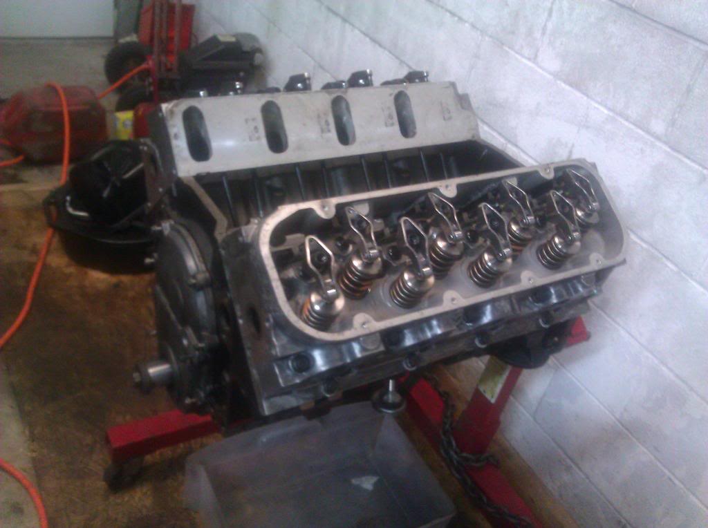

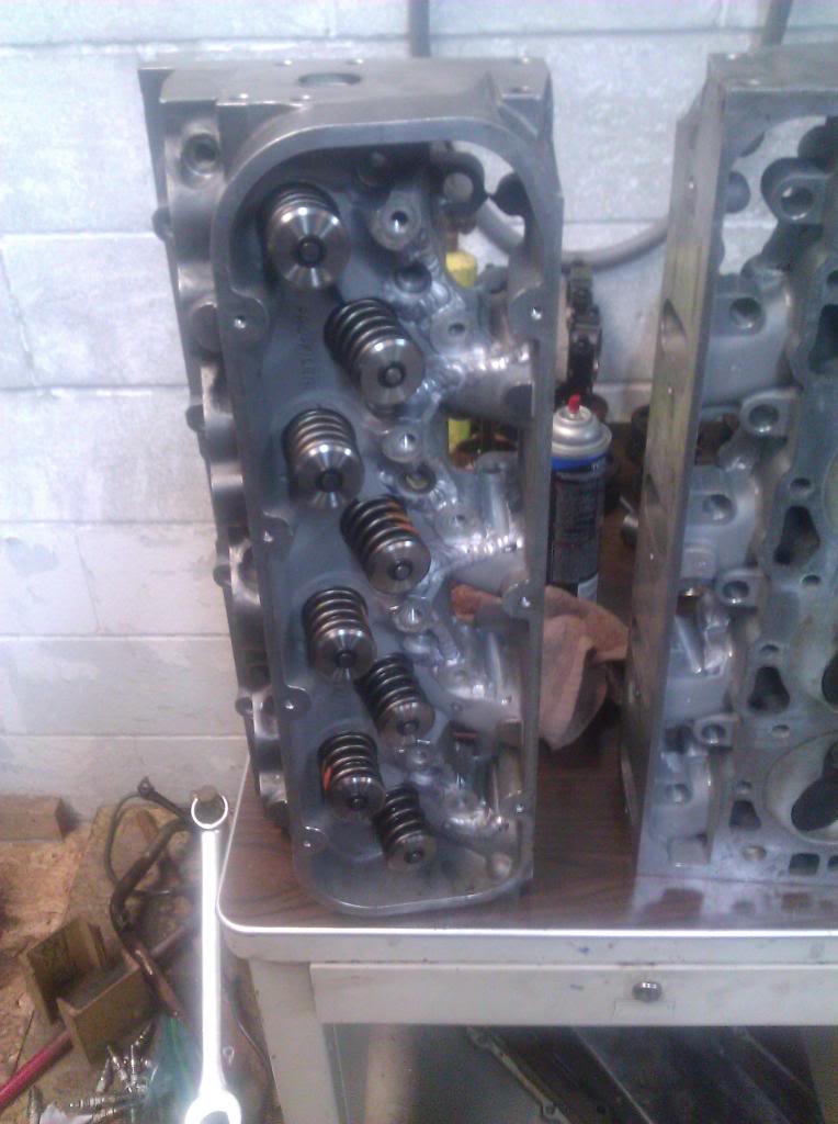

and working on the new engine for it...
