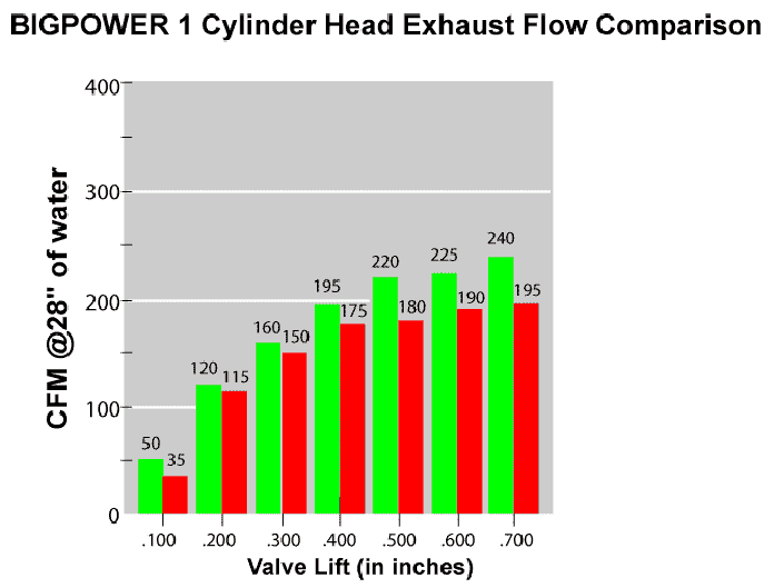

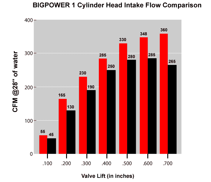

Crower 4340 crank, oliver 4340 forged parabolic rods, Je 2618 pistons coated etc for boost. Dart Big m block, the aluminum heads you see in the pics with the turbo manifolds. At least a 12 quart oiling system, on top of the 1.5 quart accumulator preluber i have. Titanium intake and exhuast valves. Titanium retainers and keepers. Isky springs. Jesel rockers. My custom high flow intake manifold. 102 mm TB. Billet atomizer injectors probably something over 210 lbs. Magnafuel 2500 hp pump. BIg *** intercooler and may if use an air to water as well. 5 inch down pipes to 5 inch cutouts then a dual 4 inch system when cruising around. .650 lift cam on intake and exhuast .244 @ .050 on intake and exhuast. The flow numbers for the heads are posted below but he uses a 1.7 exhuast valve so probably will open that up to 1.88. but keep the 2.19 intake valve. compression will be 9-1
