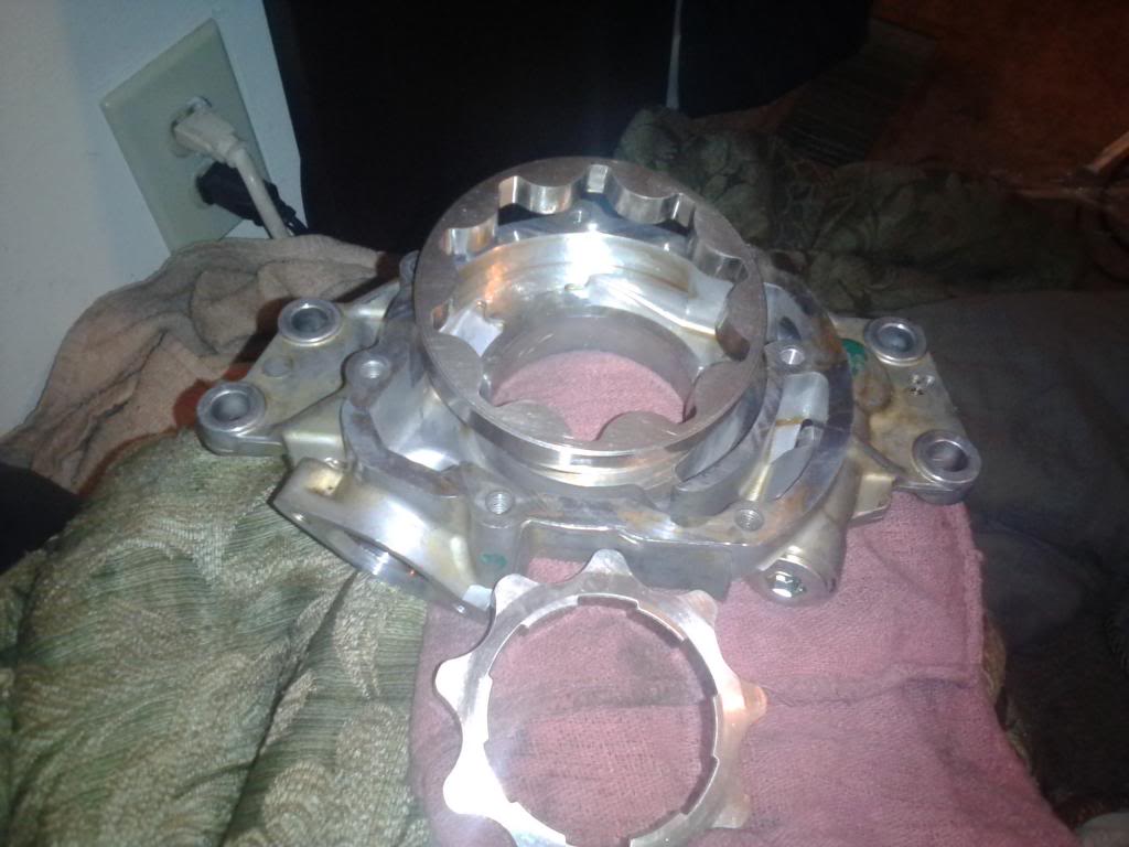

NO LIKE AN IDIOT i didnt take the pan off when i tapped it.. today i got the pan off and the pick up was clear but i could see very fine shavings from tapping in the bottom of the pan so im pretty sure the valve in the oil pump is stuck.ill have it off next week when im off again
Old Mar 11, 2014 | 07:42 PM
  #23
BUTTERB30's Avatar
Joined: Apr 2011
Posts: 161
From: N.C.

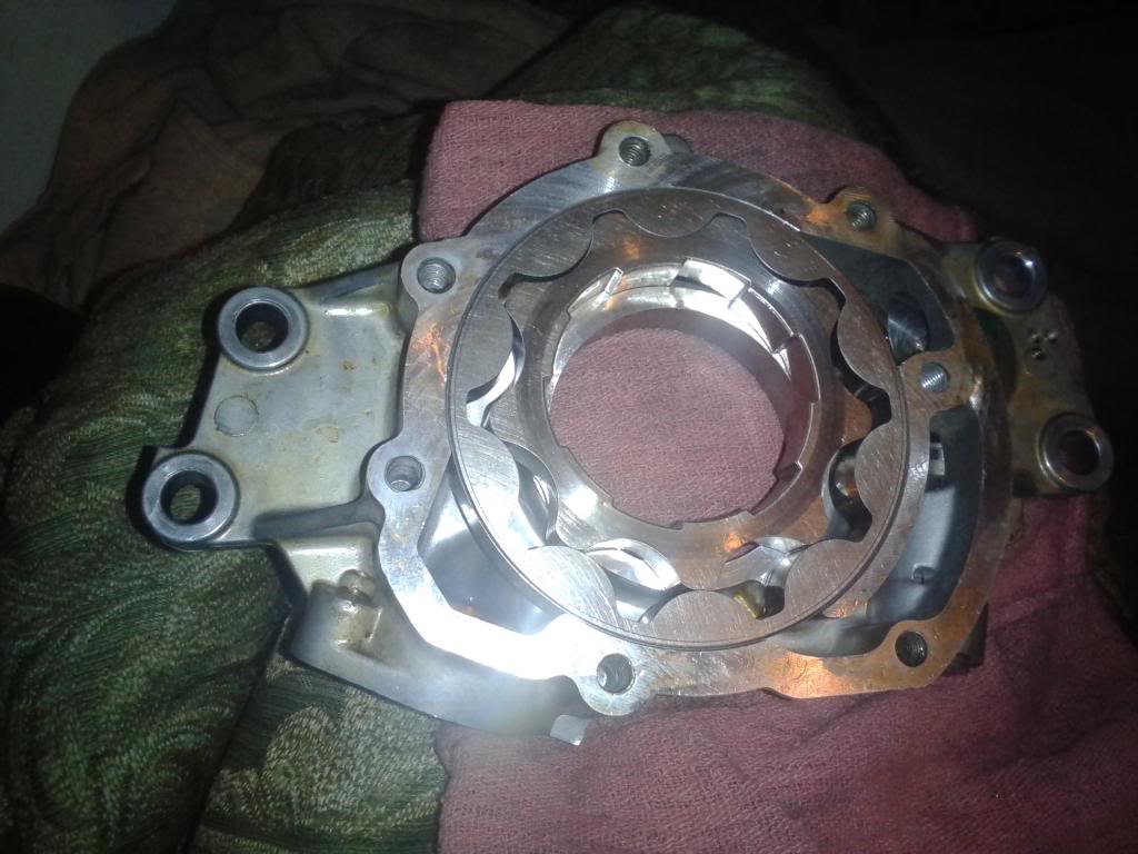

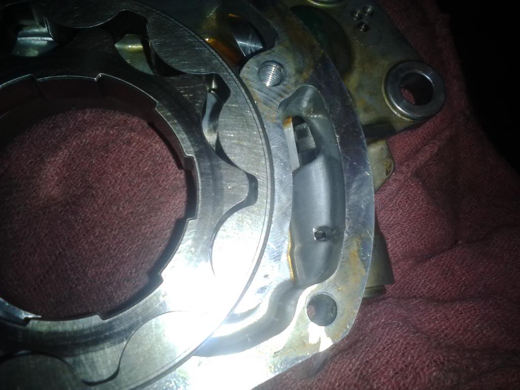

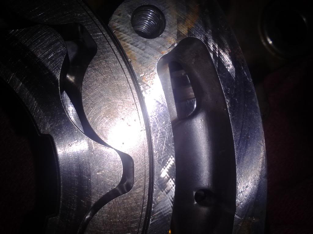

so found the problem and i now have oil pressure in the truck so back to installing the kit and thanks everyone for all yr help!!!!! PICS BELOW
the oil pump looks normal enough huh???
all my troubles for this little valve that got stuck ugggg
