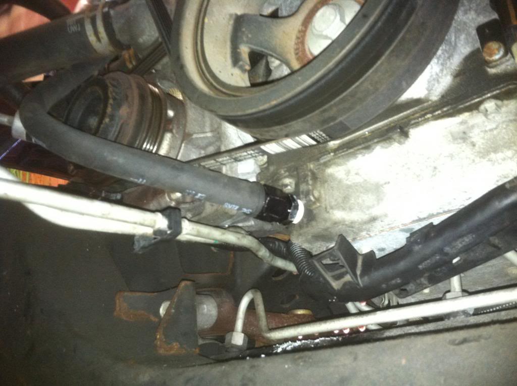

yes for my return line i had to drill and tap. i went with the very front of the oil pan just under the crank pulley like i saw member CHODA had done

Old Mar 6, 2014 | 04:09 PM
BUTTERB30's Avatar
Joined: Apr 2011
Posts: 161
From: N.C.
mine is a little right of that
