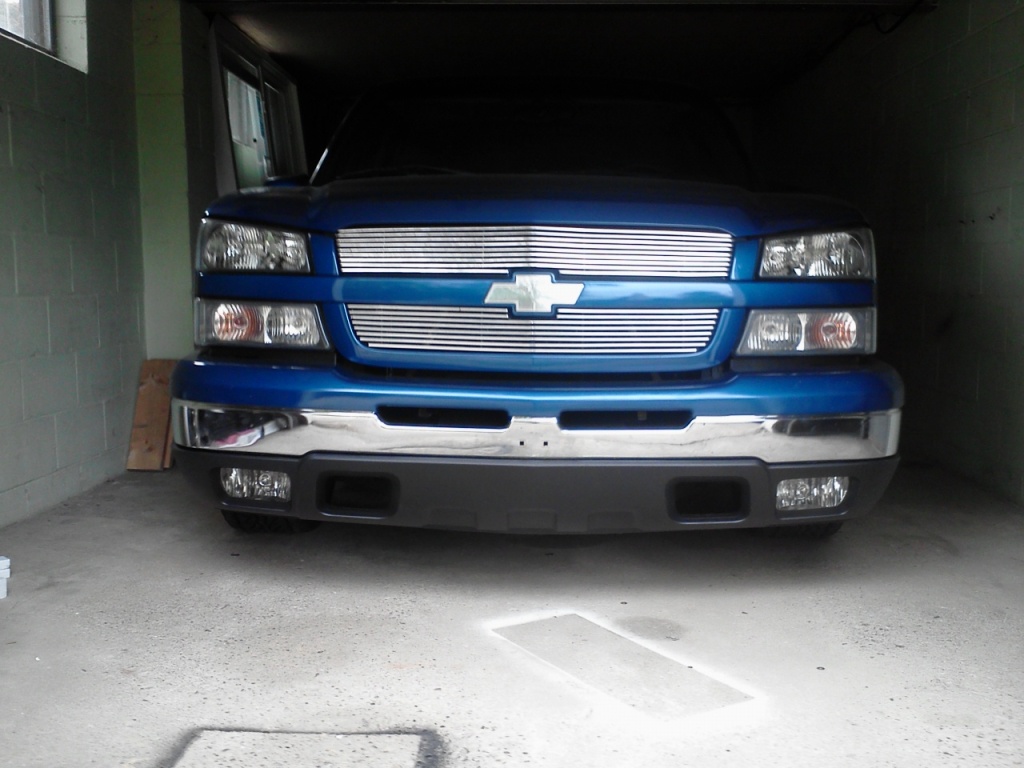

Saturday, bought it off a dude on GMFS. Thanks btw
Mild cam and TVS.
This is probably going to happen
Woohoo! Black valance
