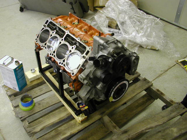

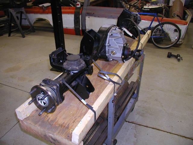

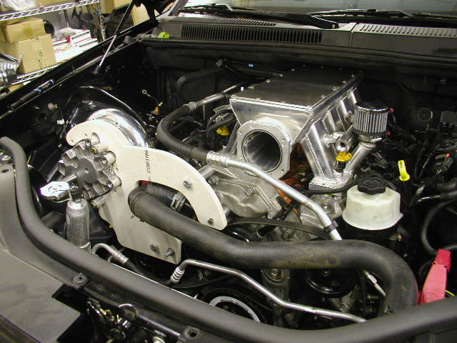

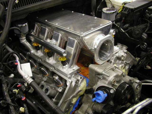

Well this build is on plenty SRT8 sites but since i'm a true GM guy (which is why i come here for my suburban) I wanted to update you all with a pretty cool project. It is a 07 Grand Cherokee SRT8 with 14K miles. Here is an overview of the parts we will be usiing
The build is as lists below..
HHP/BES 426 7.0 with every bulletproof option availible
HHP/BES Custom suprcharger manifold
Full custom bracketry for supercharger
Vortech YSI-Trim Supercharger
MSD Ignition Coils
Kooks headers catless coated
B&B exhaust
Innovate Data logging and gauge setups
Renntech Modified Transmission
Jerry Bickel custom Driveshafts (front and rear)
9" ford rearend with ARB locker
Safecraft fire suppresion system (can never be too safe)
Meticulous Fab custom Rollbar setup
and much more than that
O and this is meant to be a 9 second SRT8 before the nitrous.. which would make i the fastest one in the world
http://picasaweb.google.com/BriansSRT/JeepRebuild
Check that link with full pics an descriptions ans ask away...

Project started 10-22. Thats when the stock 6.1 with the ASM setup went kaboom. Takes some tim working with these new hemis since we are still prototyping parts which sucks some times and certain venders didn't come through for us. Hopefully we will ve wrapping it up within a couple months and the snow melts. Located in Milford Michigan
