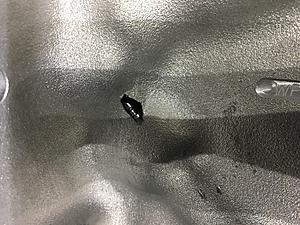

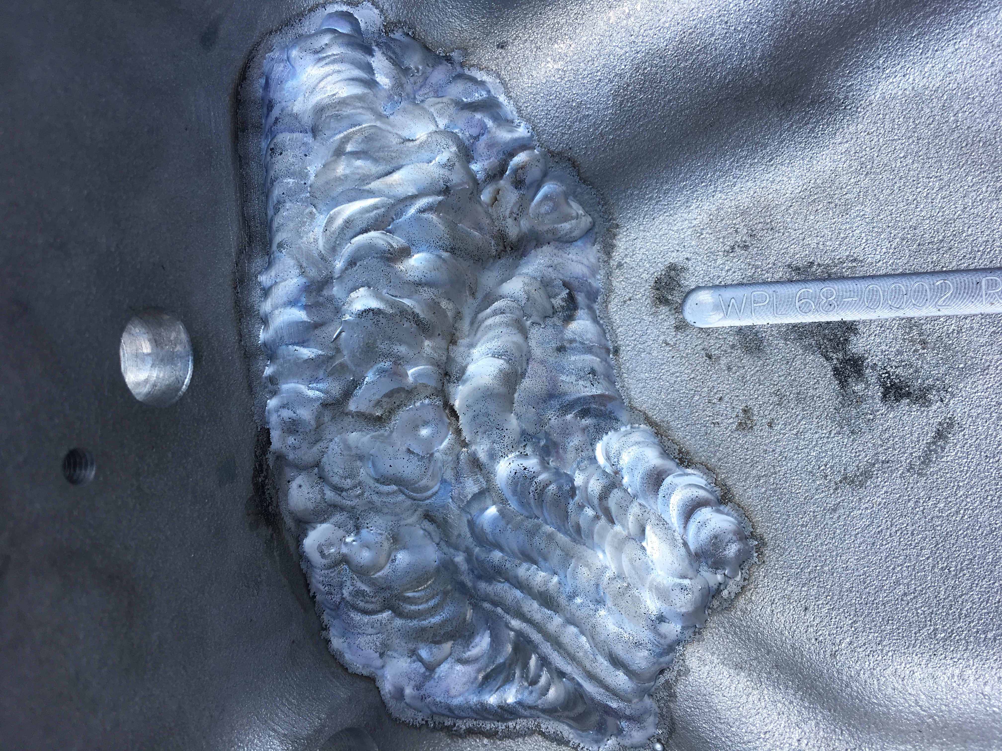

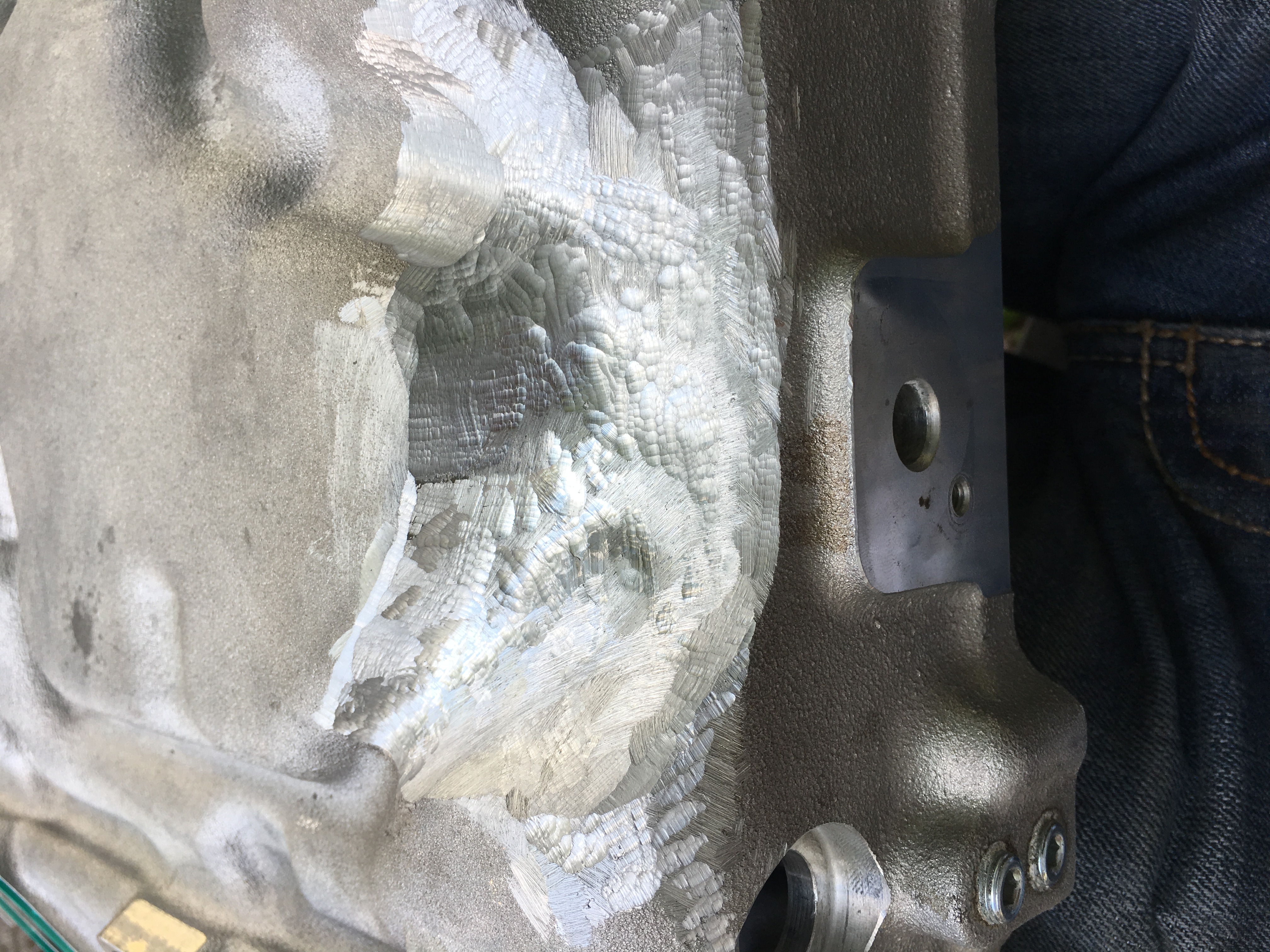

An LT4 hpfp and injectors are being installed on my 5.3 2016 Silverado. They’re have been lots of problems with interference. There’s not enough material to fix it by grinding the manifold. Adding weld metal should have worked but there was too much cracking. A little fabricated box has finally been welded in allowing the manifold to fit correctly.
i read where some folks install these with no issues so there is significant variability in the castings. Milling the pump would have helped though I’m not sure if that alone would have been enough.

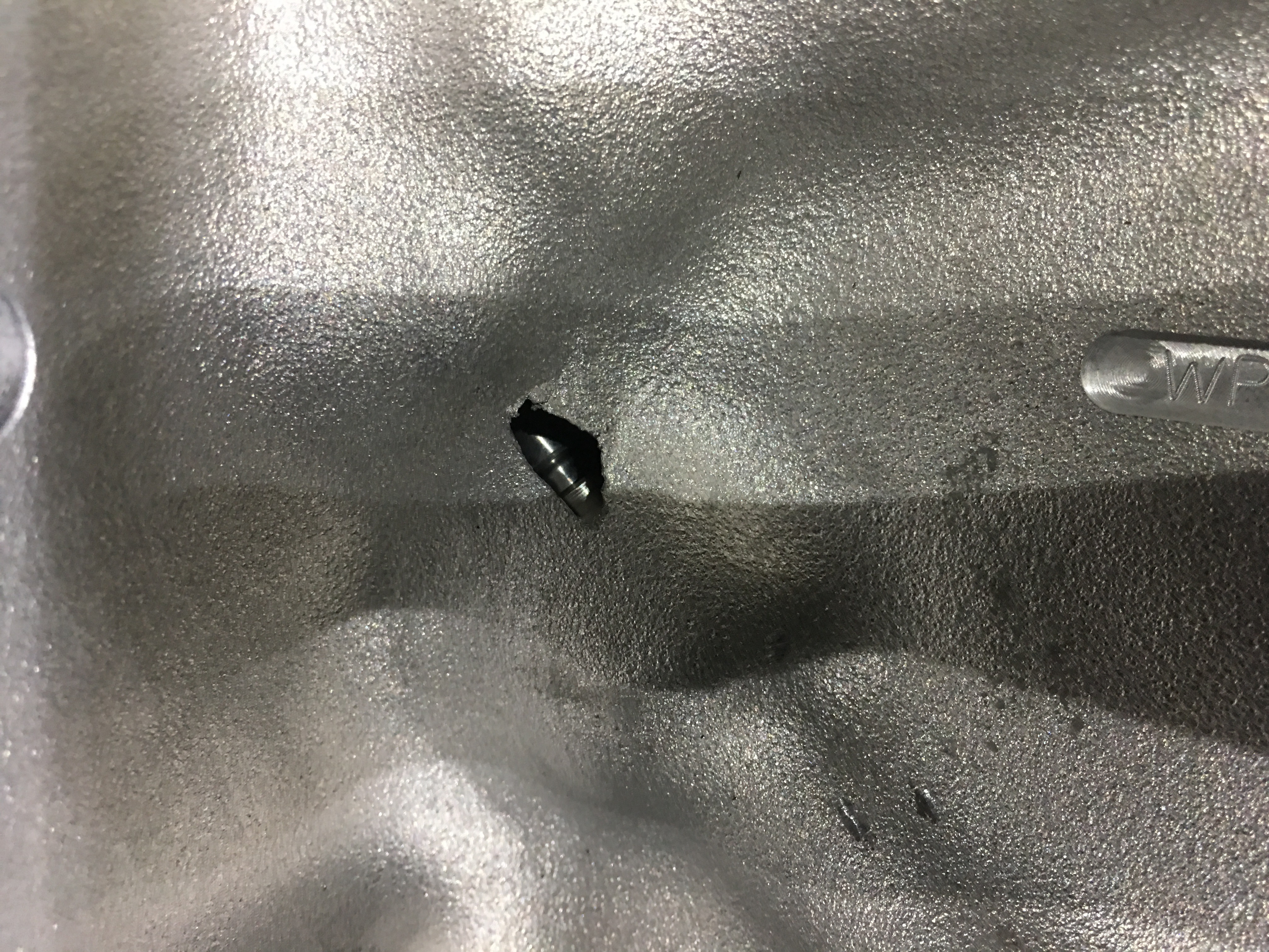

Do you have any pictures of the install or issues?

You can see a penetration in the one picture causing high idle. Not sure the exact amount of interference but it’s not tiny.
