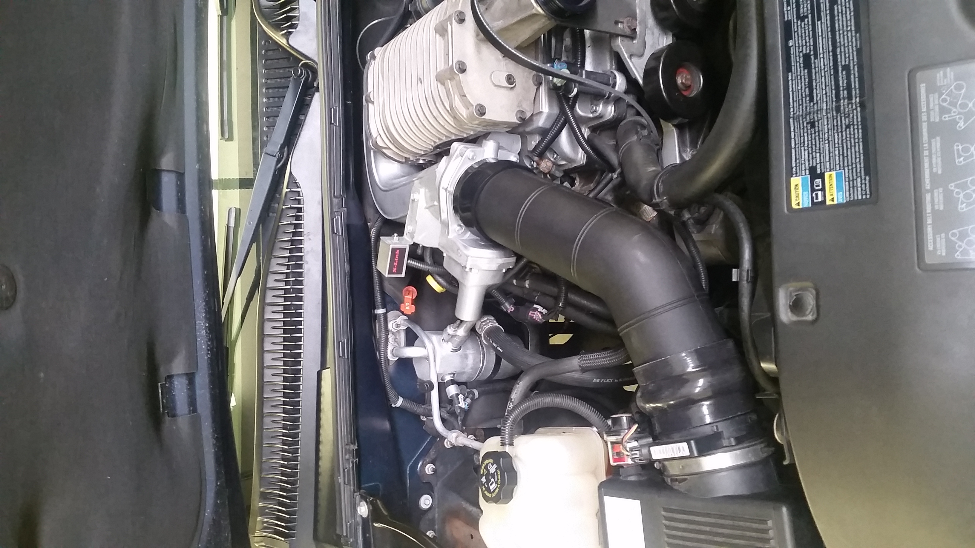

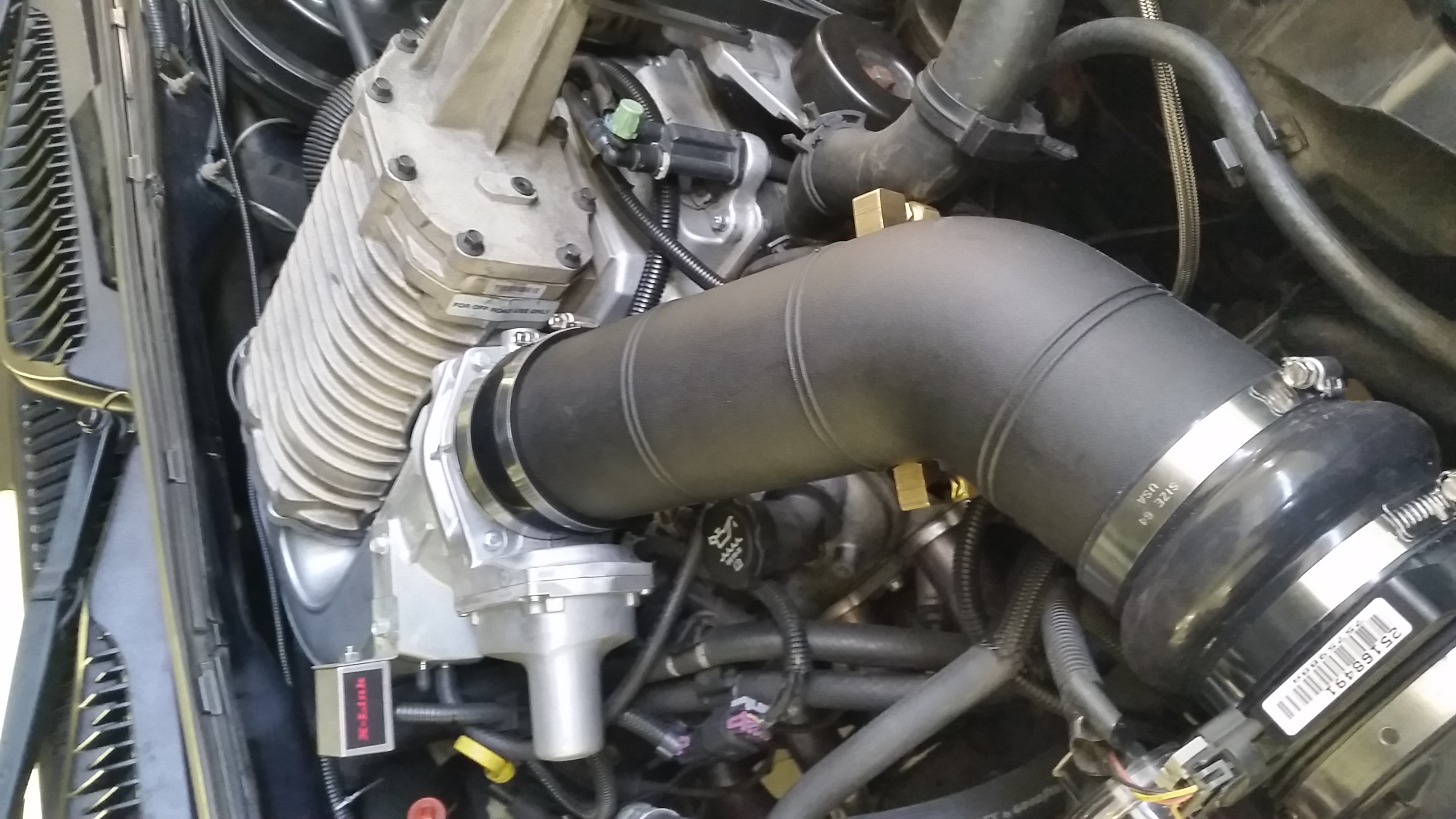

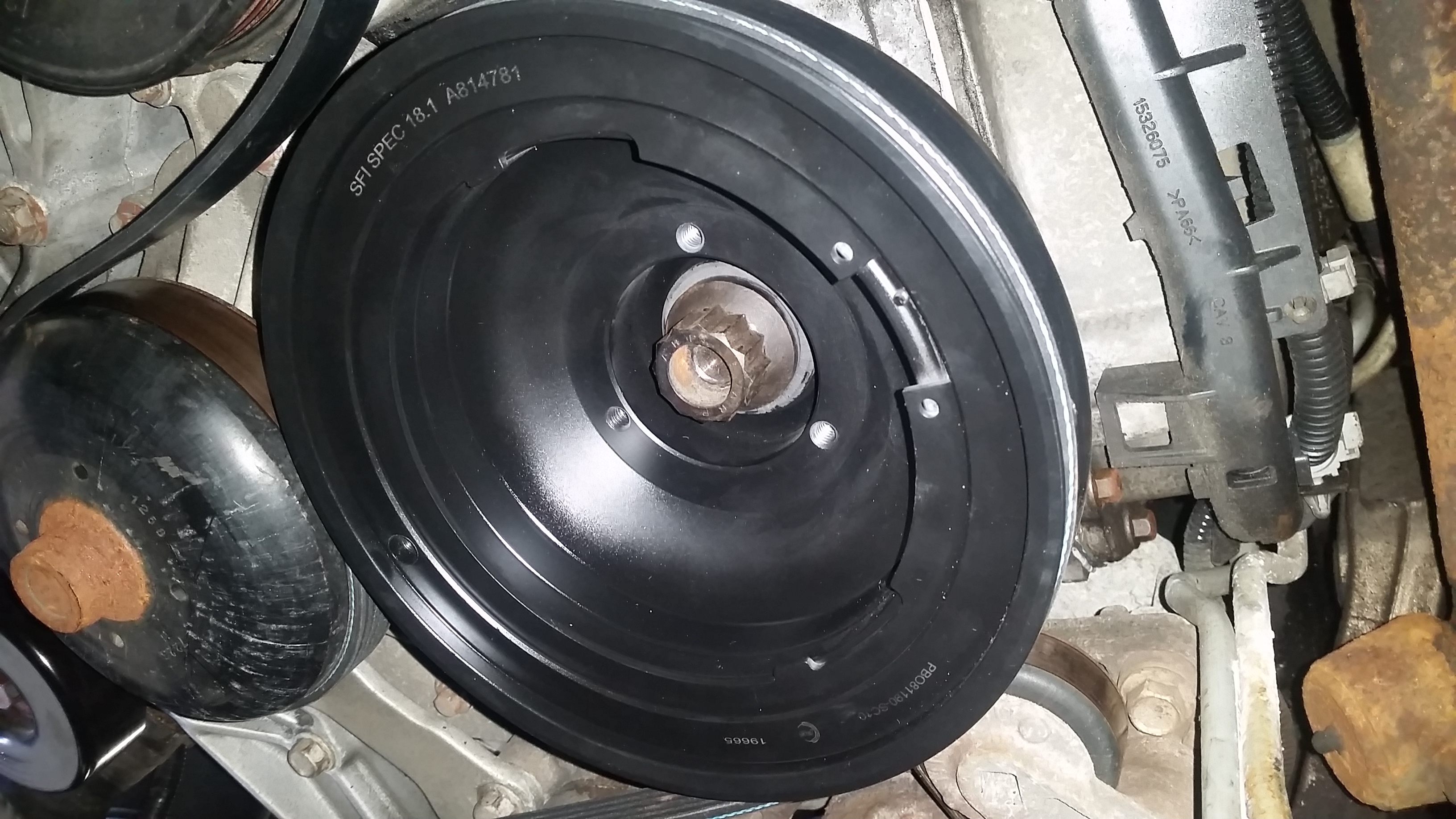

Ordered a powerbond overdrive pulley about a month ago and got it on the truck this past weekend. Super easy install as long as you have a puller to get the old pulley off. I'm working on mounting another idler pulley under the blower for more belt wrap as other members on here have done, just trying to come up with a 60-68mm pulley now.
I also finished up going to a complete 4" intake by replacing the factory magnacharger intake tube with one I cut from an Airaid kit and some couplers. Inside diameter of the factory tube was around 3.5". The material is a little heavier and should work well when it is tapped for meth. My alkycontrol kit also just came in, I should have it installed in a week or two.

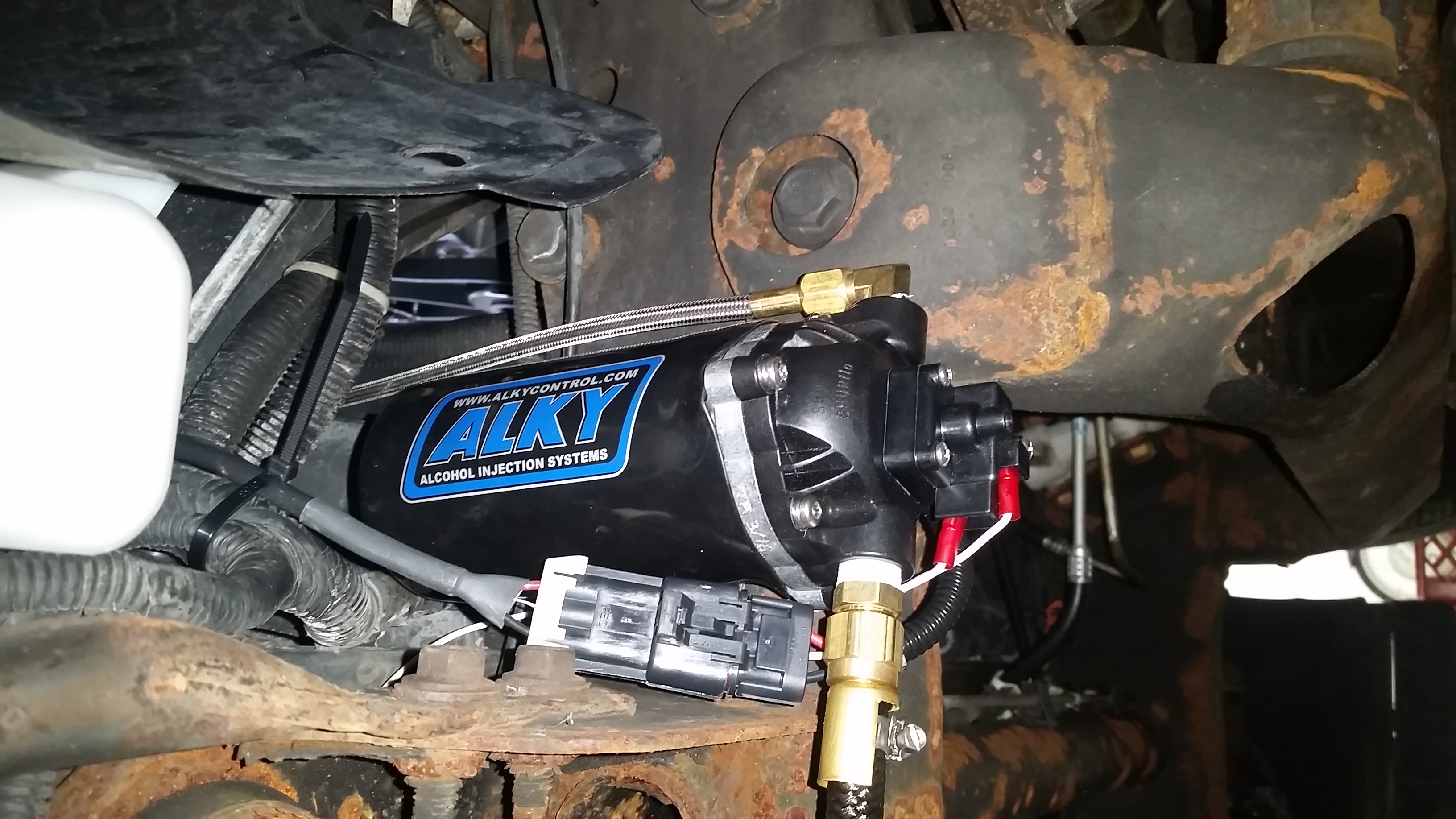

Finished up the alky control install this past weekend, dual nozzle was recommend by Julio. Just waiting on an idler pulley now to achieve a little more belt wrap on the blower itself which will hopefully be here Thursday.
