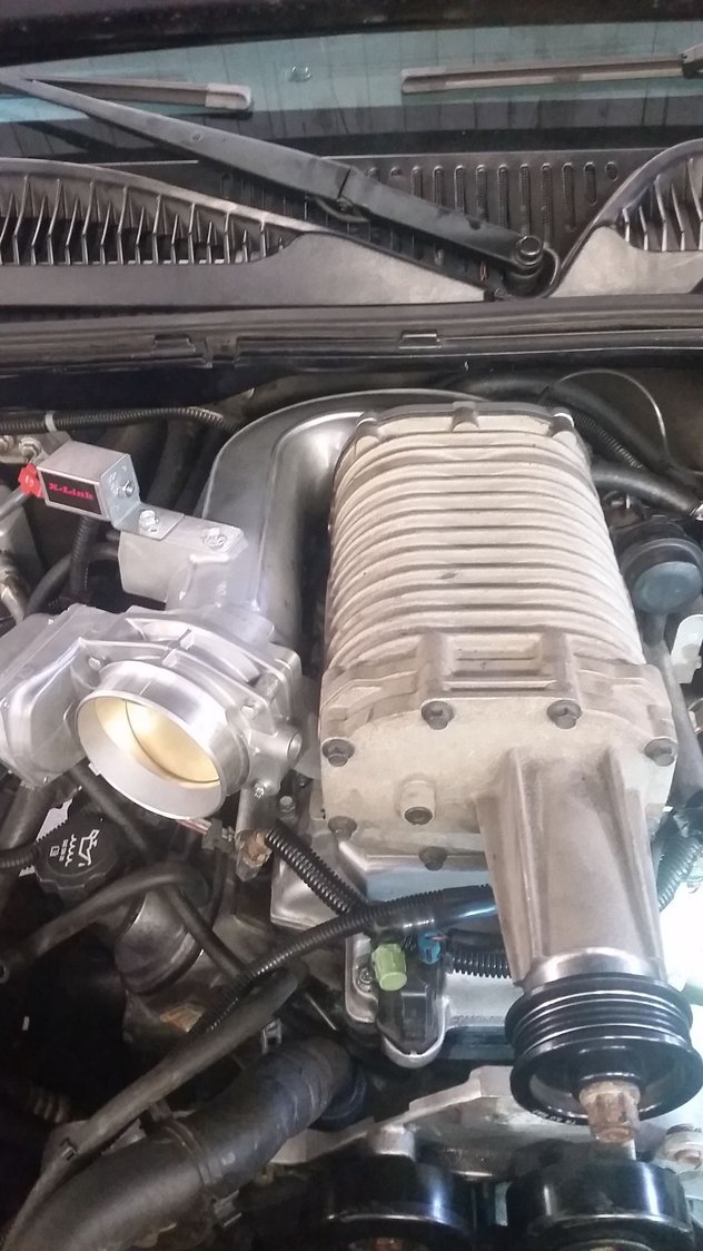

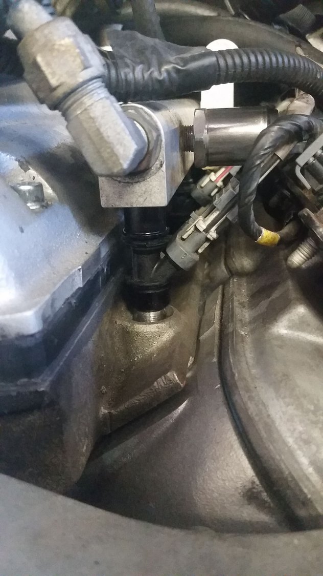

Little update! I installed the larger 90mm j-tube, Ls2 throttle body, a 2.8 pully I had rip cut and a 1/2 inch phenolic spacer.
I also replaced the stock 65e with an RPM lvl5 and a yank ss2800. Waiting for a call back from Slowhawk to schedule a retune now. Getting that phenolic spacer and getting it installed was a real hassle so I hope to see some decent power gains from all the above!

From: Austin, TX
where did you get the spacer and how much was it? I'm curious to how much of a difference it makes
Old Sep 30, 2015 | 01:28 PM
  #26
Y-B-Slow's Avatar
Joined: Nov 2007
Posts: 63
From: Ma
It was pricey close to $500.00 I ordered it through super street but I wouldn't do it again, told me it was in stock ready to ship and I didn't see it for more than month. When I did get it and found out I needed injector spacers I tried to call and order some, all calls and messages went unreturned, terrible customer service considering the price. BUT I'll keep you posted I've read a lot on them but I'm pretty interested to see the actual results myself too. We have similar builds, have you had your truck on the dyno?

From: Houston, Texas
Very interested to see results too. I've read the 90mm throttle body is worth 20-30rwhp alone.

From: La Vergne, TN
Where did you find a 90mm j tube? I've been looking for one for my truck. And which injectors ended up being right? I've got 42's and want to get some 80's.
