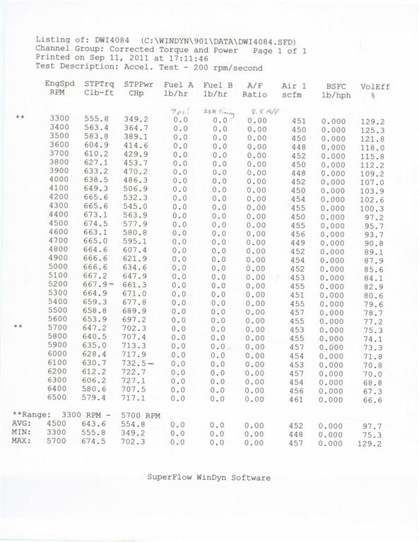

Well i have a kick *** looking engine atleast. Well the engine didn't make near as much as i thought. With the roots blower i knew it wouldn't be a power horse but i'm not impressed much. Anyways here's the results.
6 lbs boost 25* timing 9.0 A/F ratio 88degrees AIT start to finish of pull= 705.2HP@6,500rpm 664.4TQ @4,700 rpm.
9 lbs boost 23* timing 8.5 A/F ratio 126 degrees start and 162degrees AIT end of pull= 732.5HP@6,100rpm 667.5TQ @5,200 rpm.
15lbs boost 17* timing 8.0 A/F ratio 183 degrees start and 209 degrees AIT end of pull= 722.9Hp@6,300rpm 678.3TQ @ 4,600 rpm.
Any input or suggestions? I have tomorrow morning yet to dyno if needed. I'll try to post dyno sheets and videos soon.

Iats are getting to you on the high boost pull, the low boost is pretty impressive! Try a high boost pull with some cooler iat's to start, looks like it was hot already.

Here's some dyno pulls. Most all data is on my ecu that's why not much data on these.

600ftlbs by 3500rpm, gotta love blowers
