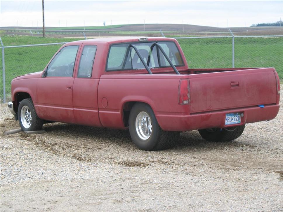

Nice build man, good to see more obs on the sight! Those wheels look very familiar! More pics......

That looks like a fun build , the truck is definetly unique by itself
