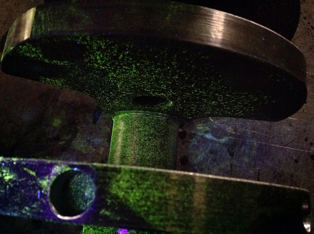

Long story short engine turned to junk on the dyno. #1 main bearing went out, #2 main bearing cap busted in two pieces, crank has multiple stress cracks and is junk. Engine builder and dyno place isn't covering one thing so I took everything out of his shop and back to mine. I'm going to a 565 bbc with my blower and injection. But everything else is for sale. FTI cam, lifters, pushrods, and rockers. Ls1 lower blower intake, afr 235 keith craft ported heads, rods and pistons, I'm sure I'm forgetting some.

Here's one pic
