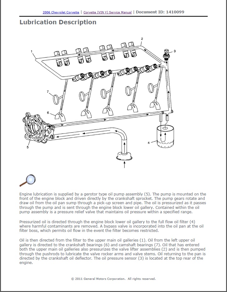

Now that I think of it.... is that galley plug on the block on the passenger side pre filter? Anyone?

Found this on the corvette forum, hope it helps.

That's what I was thinking. Looks like I'll modify the oil cooler bypass cover instead.
Thanks for the diagram!
